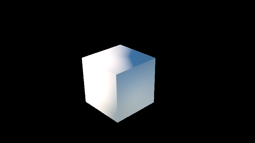

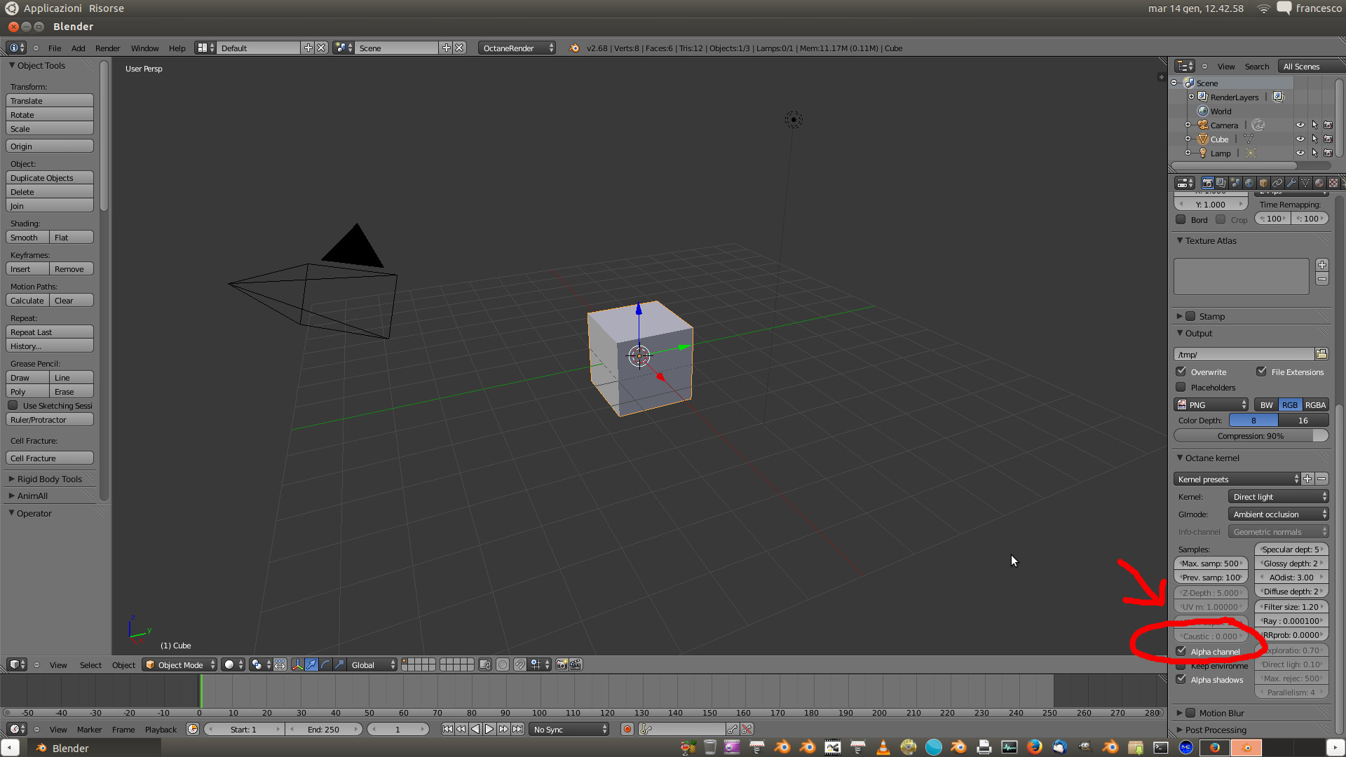

Hello Jimstar when septum alpha channel in the render panel preview is correct, but if I see the rendering me from the background black.two screenshots.
Why?.it is my mistake?.Sorry for my bad English

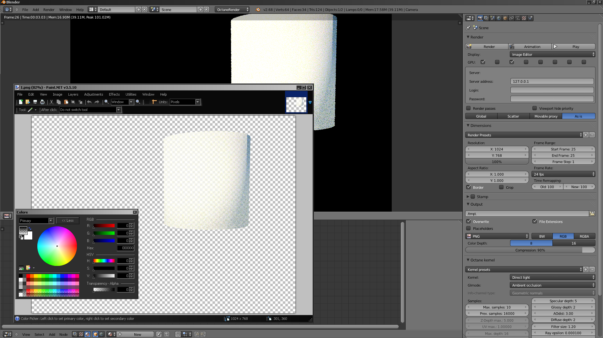

When you render by "F12" - the image renders as HDR (unlike live-preview mode where the image has only 8 bit per channel). So, in this regard these modes are different, and this is how Blender image editor shows you this final image.
But if you save it (choosing "RGBA" when saving) - and look at it in some external image-editor it will have alpha-channel (I've saved it as 16-bit per channel file in this case):

Thank you so much. It works.I look for an upgrade of patience BlenderOctane
