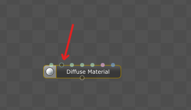

FamilyGuy wrote:can't find transmission controller in diffuse material.
The transmission parameter is hidden by default (I'm not sure why), so you'll have to use nodes:

Thanks matej. Now it works perfect!
