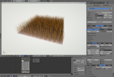

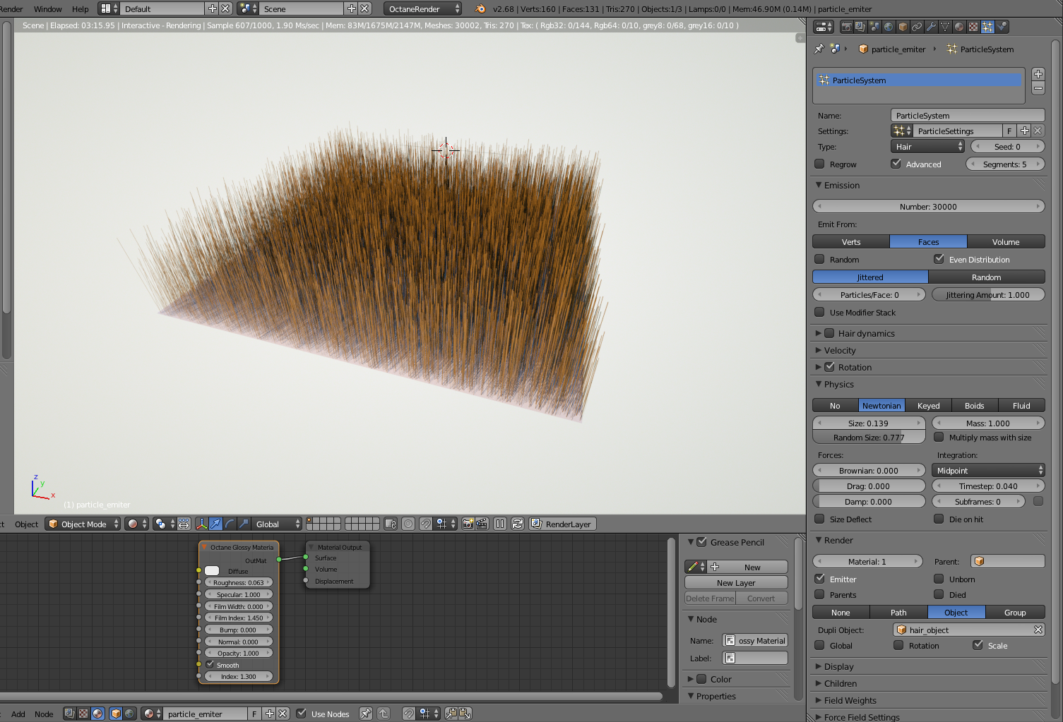

Hey all, Does anyone know if the new plugin currently does or at some point will recognize particles or particle hair created in blender?
JimStar
Posts: 3852
JulianLife wrote:Hey all, Does anyone know if the new plugin currently does or at some point will recognize particles or particle hair created in blender?
Sorry, I'm not a cool 3D-artist, so it's what even the programmer can do in a minute.;) I think artists here are able to show something better...
But you should understand, that Octane engine so far does not support the native hairs, as Cycles does. So, so far you can do it only using Blender particles.
