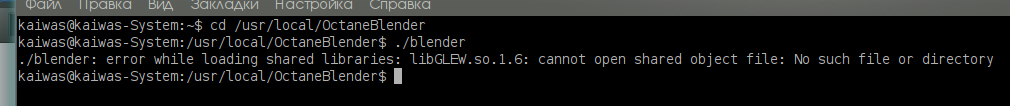

sorry (
But now this ...
installed in the system libGLEW1.8

kaiwas wrote:sorry (
But now this ...
Just add libGLEW 1.6 libraries to this system.
