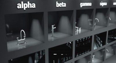

I started using proper scaling, so what's 100cm in real life is 100cm in C4D.
Now I don't have to give each light 20'000 power.. Now 100 or 200 is enough in most cases.
The way of mounting the light is different. I used some torus to give the light proper modulation. Now I just use extrude inner, and extrude so the light is in some sort of "tube" inside the ceiling.
I'm using light sampling at "1" value. No idea if it changes anything, but it doesn't hurt too ;)
Honestly - in every new scene the hotpixels dissapeared...
Below the "straight-from-C4D" image after small color correction (no other retouch).
I'm rendering the pmc/5 shot now, but it will take next 5hrs cuz I'm willing to give it a downscale.
Seams like the scene sizes were an issue....
So thanks to iFloris for giving a good hint. ;)
cheers!
PS: below is DL/diffuse, 6/6 / diffusedepth:3. maxsamples:4000

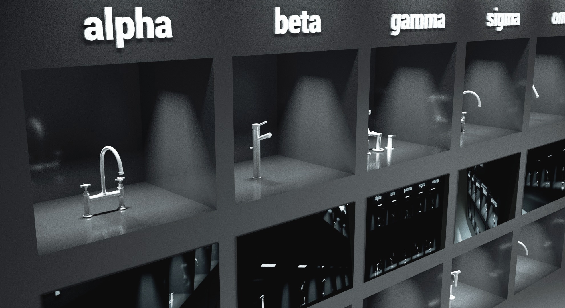

slepy8
Posts: 377
Joined: Sun Jul 14, 2013 10:53 am
PMC/5 maxdepth: 10'000
hotpixel value: 1
no downscale, "straight-from-c4d" image
NO NOISE!! :D
