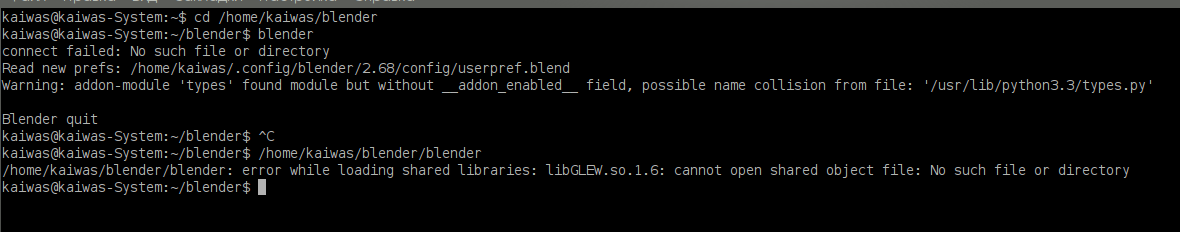

still does not work (
Everything tasted. The original recipe also does not apply.

Hi kaiwas,
still does not work
is not a error message, nobody can help you with this informations.
Start OctaneServer and Blender from a terminal (xterm) to get meaningful error messages.
If you don´t know what a terminal is, it is may better to go with the Windows version until the Linux version is more mature.
I , as a long term Linux user, had big problems to get the Linux version working but with the help of JimStar I got it running.

The original executable file from the archive does not run. Even from the terminal.
installed in the system libGLEW 1.8
sorry for the trouble!

Ah, make a symlink to your libGLEW.so.1.8 with name libGLEW.so.1.6
ln -s libGLEW.so.1.8 libGLEW.so.1.6
in your lib64 folder.
Same with other missing dependencies.
