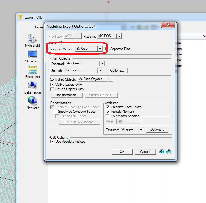

and you have only one material in the materal editor in rhino?
Only one white?

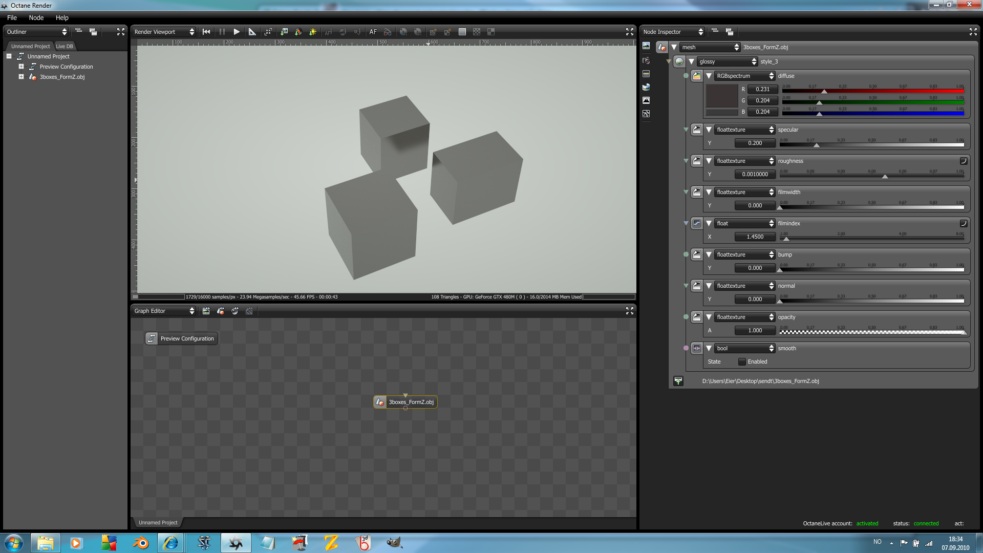

It came out alright from Z
here are the files

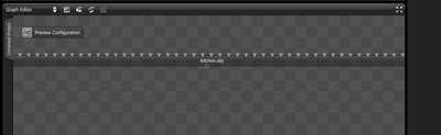

Hi Henrik,
I'm exporting from rhino, and don't have such option. I've tried almost all possible combinations on the export settings and it didn't work. And yes, I am using only 1 color, 1 layer. Going trough other aplications is no option for me, as I already find exporting from rhino a break in my workflow. I gave up. I came back to rhino plugin rendering engine until a good integration comes up, if it ever comes up.

I downloaded and tested here, and I am only seeing three nodes with the kitchen file, WHITE_DIFFUSE, CENIZA_PLASTIC, and RED_WINE_DIFFUSE. What version of Octane are you using? Can you attach the kitchen exported obj and mtl?

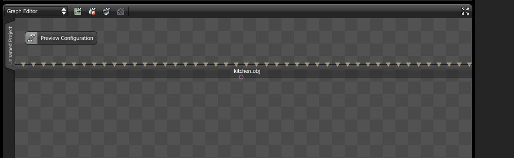

hi sam,
thanks for dropping by,
I upload the whole thing again; here you are, the thing simplified. 3 layers, 3 materials,
octane 2.2b; but happens also with 2.3 pre's
nvidia 258.96 drivers
cuda 3.1 toolkit
windows 7 32
rhino 4 sr8
tried all obj export settings. nothing worked so far
hope you got a clue!

Hi Waterthinking,
Thanks for your patience on this.
waterthinking wrote:rhino 4 sr8
Do you see this behavior when exporting out of Rhino V5? Over here, I can reproduce this bug on V4 sr8, V5 works as expected. The current version of the Octane exporter uses Rhino's native obj exporter, and unfortunately there appears to be a bug in the V4 obj exporter, so it isn't something that I can quickly fix for V4.
I will work on a fix, but in the meantime I think V5 is going to be the immediate solution.
