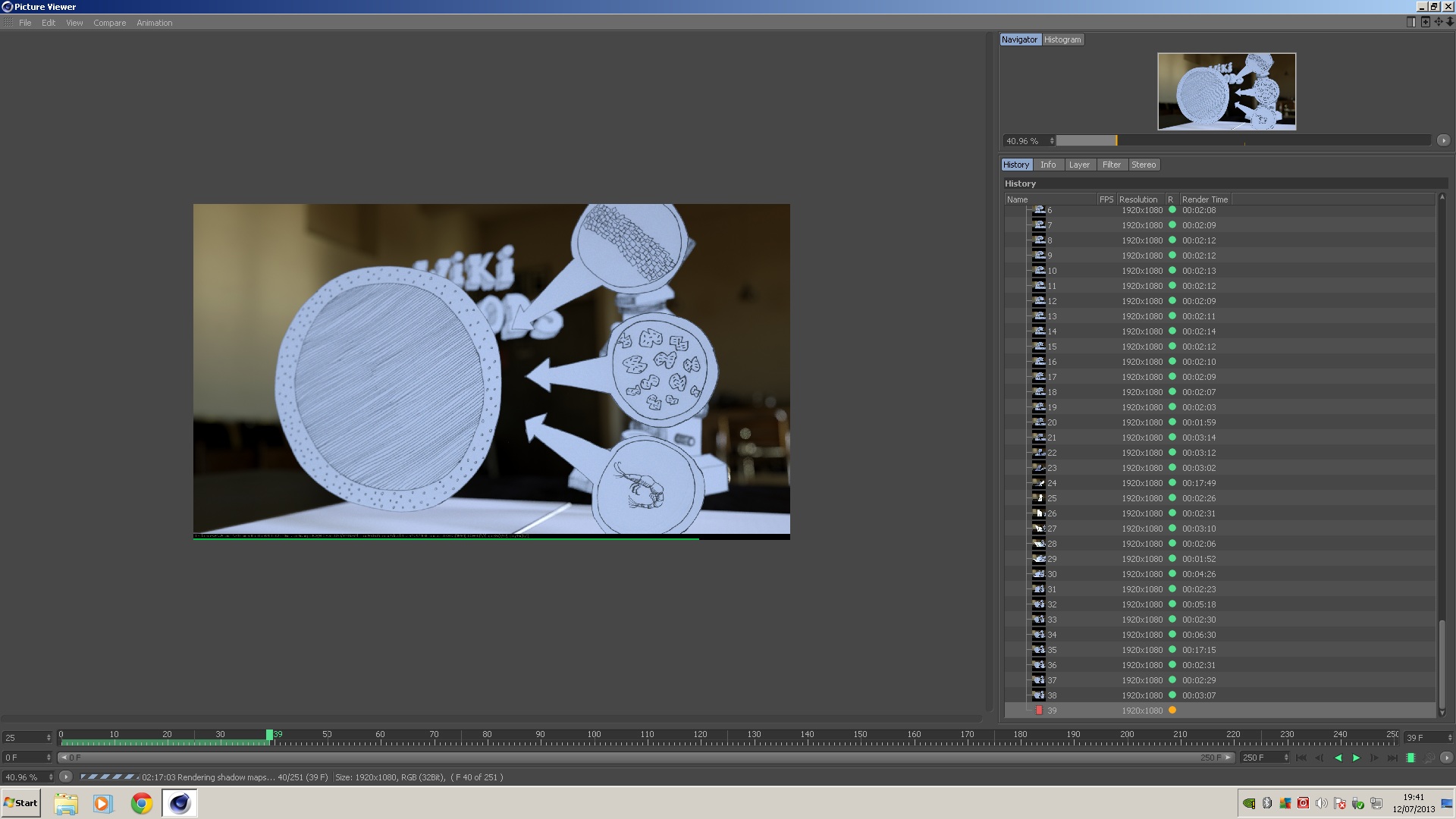

Can anyone cast any light on why I would get some frames in a sequence rendering in 1' 52" and another frame taking 17' 49" in the same sequence???
Very odd and overall making my render much slower :(

I can- please see attached. it ssems to be almost cyclical with a high render time frame every 11 frames... and similar levels of fluctuation between them... :(

pokeit wrote:I can- please see attached. it ssems to be almost cyclical with a high render time frame every 11 frames... and similar levels of fluctuation between them... :(
do you have wrong frames on sequence as double or similar to previous? What is your gpu settings on gpu section?

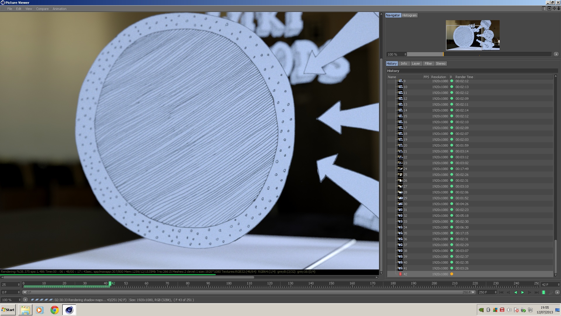

Another grab this time showing octanes data at the bottom...

pokeit: do you use your two gpu or one for rendering? I have noticed gpu/s are using nearly all memory. Can you try to lower some texture sizes and try only one gpu which is not used by system(not connected to monitor).
