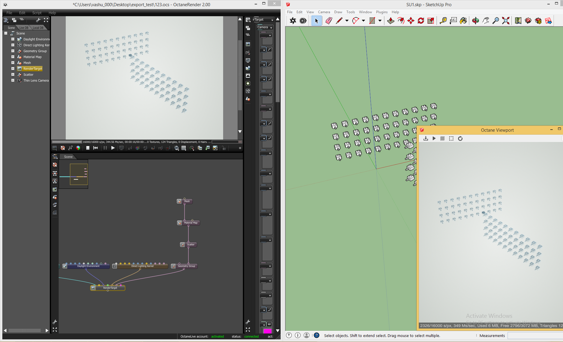

Could you please do me a favor and open the attached file and export it to .ocs using the new plugin and send it back? This will give me precise info of how the file looks like.

smicha wrote:Fuzzybro,
Sure, here you go.
The picture and the output scene data.

Oh !!!! This is far beyond my expectations! Fantastic!

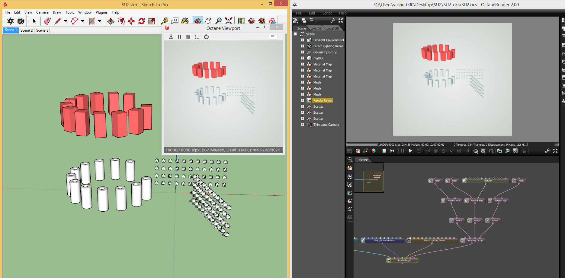

Here is one more file with scenes and two components, one of which has its proxy (created by GOSU, Renderiza plugin). Additionally one group is placed on a different layer and one more is hidden (on the second scene).
Could you please again convert the file to ocs and upload it? I'd like to see how the plugin handles different component placements.

fuzzybro
Posts: 562
Joined: Mon Jun 03, 2013 7:10 am
Location: Los Angeles, California
smicha wrote:Fuzyybro,
Here you go
SU2_ocs.zip
(11.65 KiB) Downloaded 250 times
