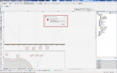

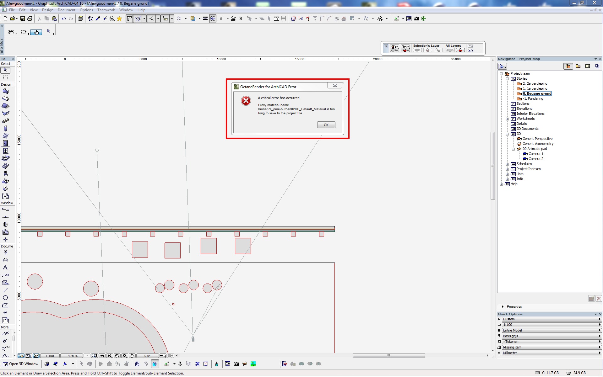

Hi Paul,
I used a few OBJ's for the proxy from my server.. maybe therefor the name is getting long (with path) and causes this error message?
When closing PLN and re-opening I got no problem though and the material seems to be loaded fine.
greetings, Jeroen
The OBJ name (excluding folder name) + material name + "_proxmat" must be < 50 characters. Just rename the OBJ and MTL file to be something smaller and the msg will go. That Octane material would not be being saved in the pln file - it would be being re-converted each time you load the pln file.
