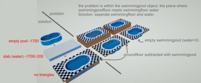

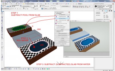

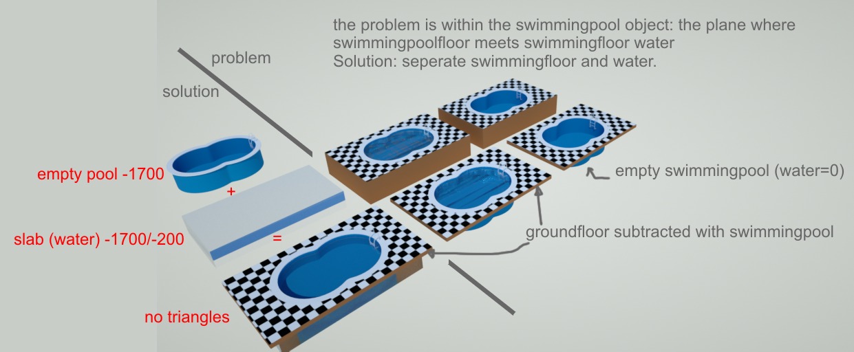

OK, now the swimmingpool object.
The empty swimmingpool on the right top shows no intersection problem with the ground floor and the floor of the swimmingpool. So the problem is the swimmingpool itself: where water meets floor of swimmingpool.
The workaround for visualization insetting water=0 in the object and adding the water as a seperate object. (that is shown it the attachment).
In this case
For you BIM information you could add a layer for the water: "Visual-YES_BIM-NO" or whatever and don't get it to your informationlists.
In some cases this will not work for your BIM-information when you have to split a object in three or maybe four seperate objects and/or maybe you want to count the exatc water (this is the example ofcourse).
In that case you copy the original object (for counting information) to layer "Visual-NO_BIM-YES" and hide it for visualization. And the others you need for the workarounds in "Visual-YES_BIM-NO".
I do this kind of workarounds a lot of times with subtracting solids (in layer "Help_OFF") from other objects.

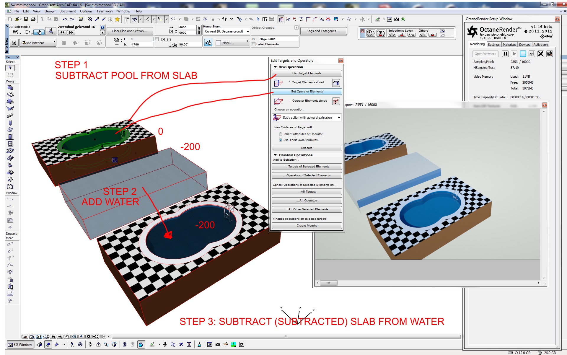

In addition to the above: A workaround withearth solid and added water not coliding.
greetz, Jeroen

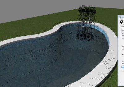

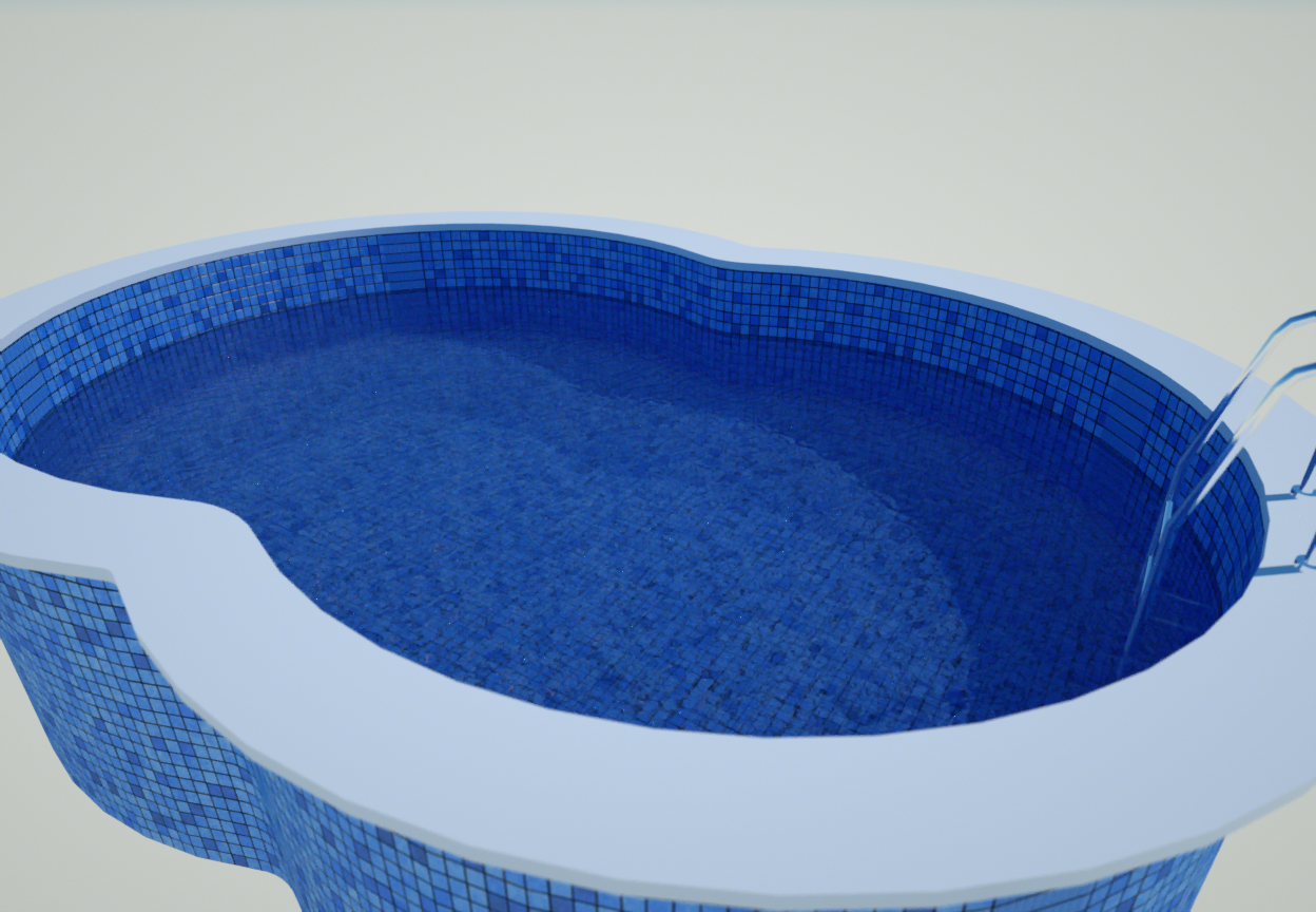

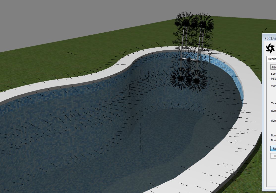

Many thanks for your replies... the thing is that artlantis make the render ok as you can view in the attachment,
but with the other engine (maxwell or octane) it has the black triangules, so I think that it can be a tweak in the obj translator... I think. Finally I make the swimming with 0 water and a plane morph for that.

Do you still have a version of the pln with the black triangle - if you send it to me (no need for the house) I can take a closer look - it's possible it could be the normals are wrong too.
Paul
Garquitectos
Posts: 118
Joined: Tue Feb 12, 2013 1:05 pm
Location: Málaga, Spain
The normals seems to be well... I think that the problem is in the gdl water object...
