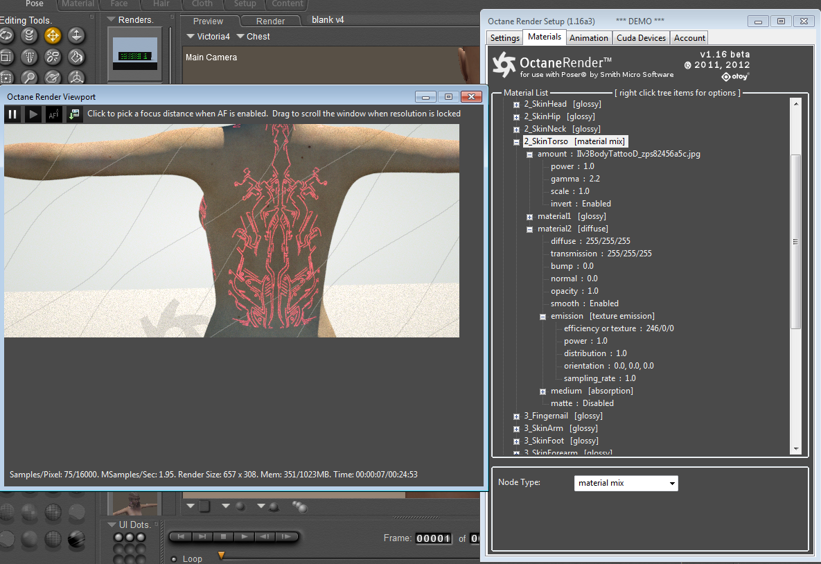

I simply can't seem to get my head around this mixed material,
Have tried like for three hours today to try and replicate what you've done, but I simply can't do it. I'm missing something.
Anyway, I'll leave that you map here and if you get time paul I would be greatly appreciated

face_off
Posts: 15830
Location: Adelaide, Australia
Try this one. Remove the zip extension. It's not a zip file.
Paul

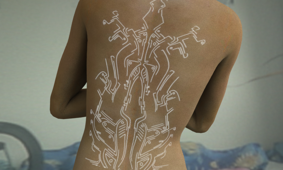

Tugpsx
Posts: 1180
Location: Chicago, IL
Try the map in the transmission channel as mixed for color.
This is a quick test.
Trans map with color mix

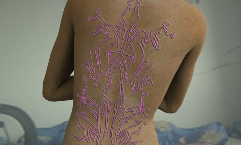

Add the map to emission channel for even more control

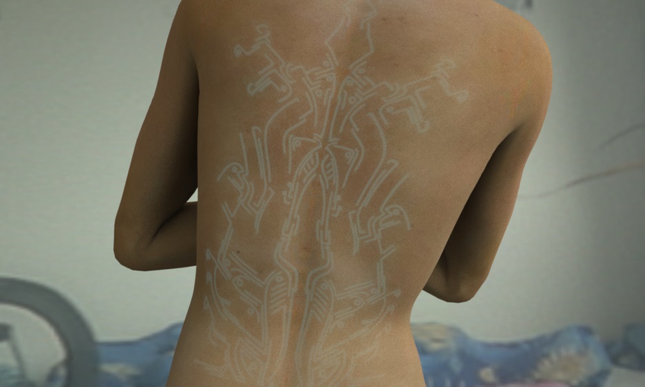

Use in bump channel to add sense of depth.
Invert bump for tribal marks or synthetic feel
