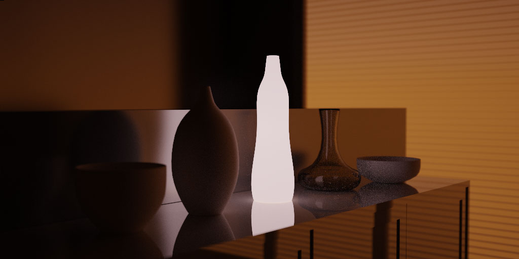

Here my quick test, I had to inport it in Rhino and check the normals in order to have proper reflections

justix wrote:Here my quick test, I had to inport it in Rhino and check the normals in order to have proper reflections
Normals is OK - they don't need any correction. Problem (or feature?) is in materials. Just try to set roughness of table material to zero (0.0000001 actually) and show me reflections from emitter. I want to see clear, non-glossy reflections.

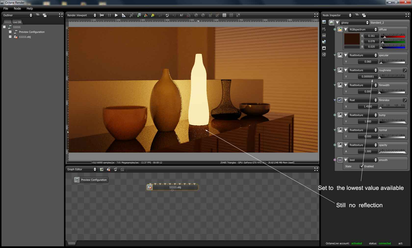

Here you go mate, I did not say that Normals were wrong but just checked, anyway here is your file 'as is' but with table material roughness set to the lowest value 0.0000001
and still no joy :(
and then the re-imported from Rhino (in my case, I use Rhino) and I say just re-imported, no normal set of any objects, only need to re-apply materials but you can see the difference, actually if you try to re-apply the material to the table you should be able to get it right, maybe some bug in your modelling software exporter or else, I can't say.
Interesting test though.. ;)
WOW! What a BUG! Procedure of getting non-glossy reflections looks like voodoo ritual. I'm going to try it. Still not a word from octane team - seems it isn't much interesting.
