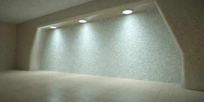

Managed to get it to look better by tweaking ISO to 400 and Gamma to about 1.4. No hope with AO though.
Feel free to try.
Lighting - I'm confused.

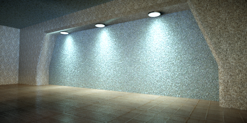

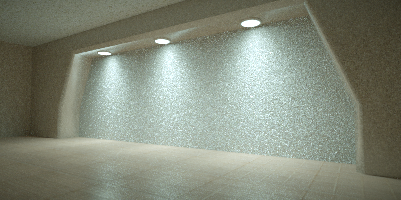

You are right, using AO you must have an environment as a fill light. What I do for this kind of scenes is setting up the emitters, then powering up the environment until it fills the black areas properly. It´s harder to get a realistic image, but it´s possible. With the diffuse mode is way easier. You are trying to light a big scene with little emitters, so you must have very bright emitters, or else raise the gamma.
First image: Diffuse mode, 3 bounces. Gamma 2.2
Second image: AO shader with HDRI env and gamma 1. The textures are crappy since they are just placeholders.

The hdri route seems to work rather well.

AO is not physical accurate GI solution. It uses environment lighting to shade the scene, not a real multibounce GI diffuse model (AFAIK).
Only Diffuse mode in the directLighting or the Pathtracing/PMC kernels allow real GI multibounce lighting.

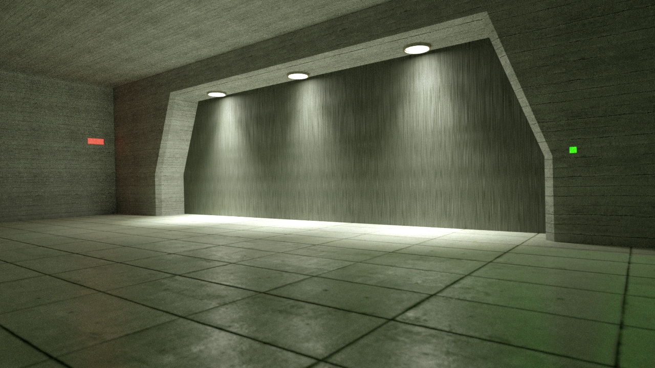

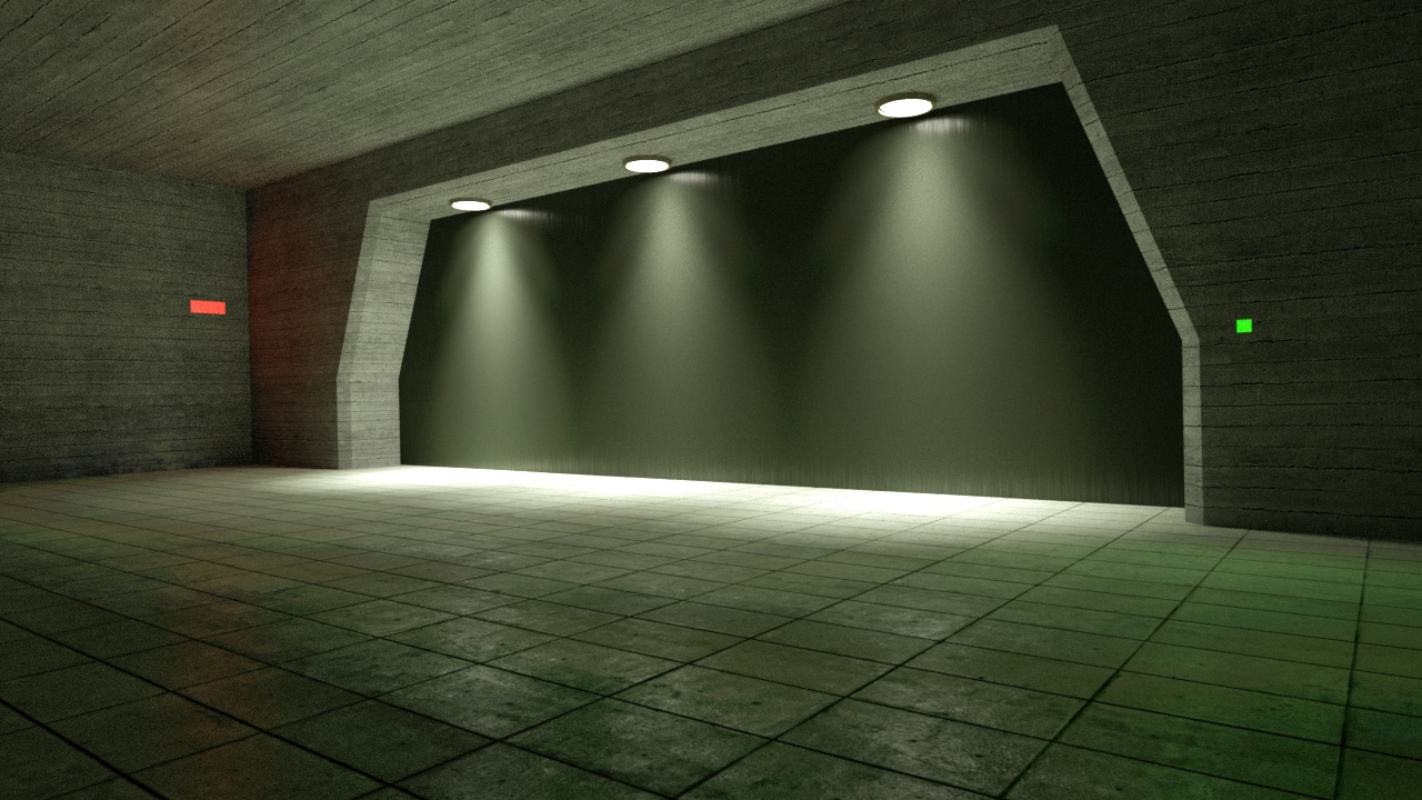

Thanks guess. In hindsight, I had remembered that the Direct Lighting Kernal was not unbiased, but had missed that AO wasn't true GI. So for internal, trying for accuracy I should be using Diffuse, or Pathtracing/PMC kernal.
I am aslo happy that I need to tweak the f-stop and ISO settings. A little less happy with exposure as I don't like the effect it has, and same with Gamma, although a small adjustment of gamma does work wonders. The image below is f1.8 ISO 800 and gamma of 1.2 with Agfacolour presets.
I'm happy with the result. I'm even getting my head round the Spec and Roughness settings. LIghtwave guys will know that Spec/Gloss worked a little differnt. So Got this sussed, I'll work on the modelling of this big scifi door later, but thanks for your help everybody peeps.
