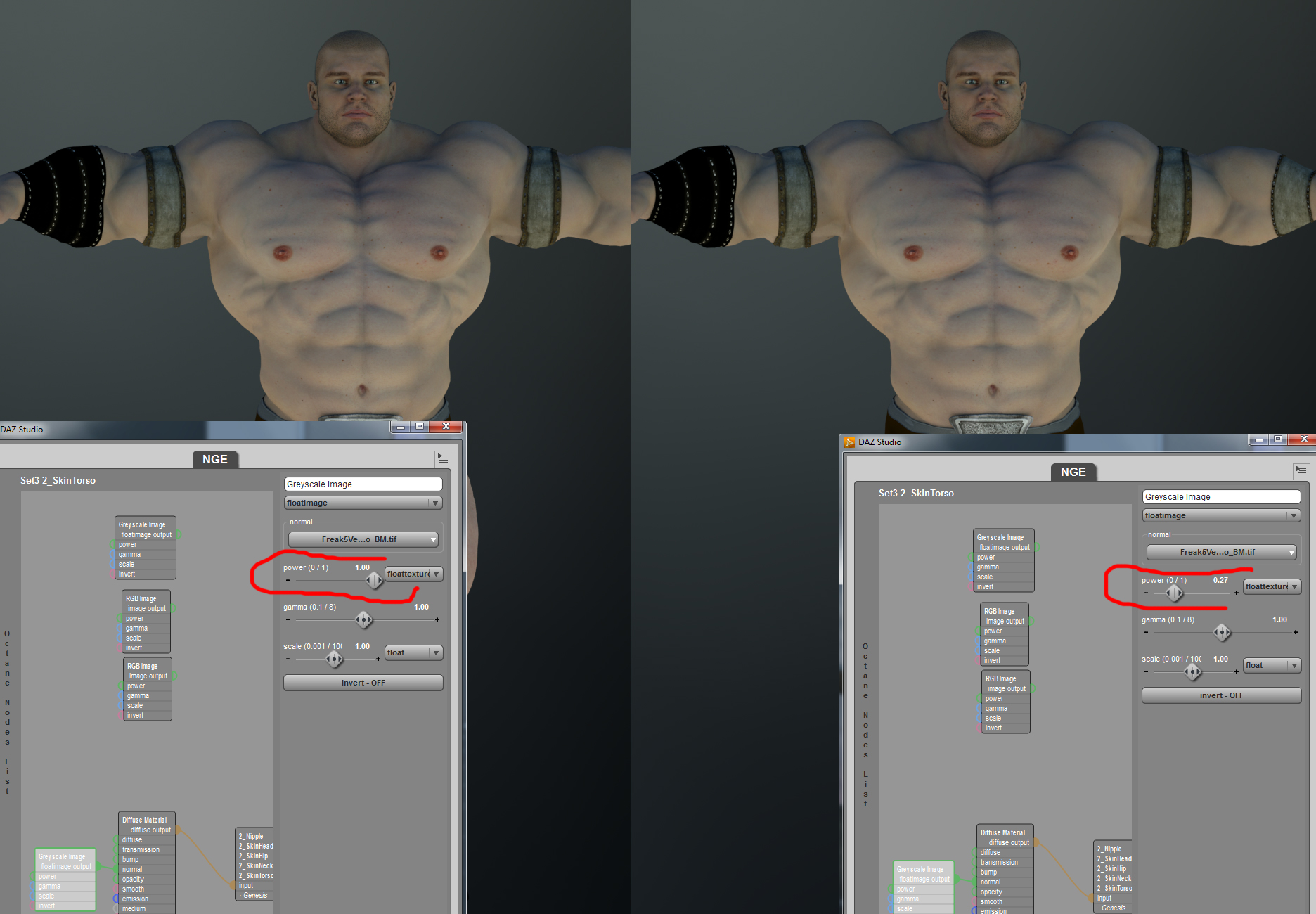

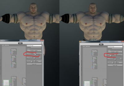

I've connected the normal map to the torso but I don't think my normal maps are doing anything. The mesh looks exactly as it did before plus cranking up the power to 1 doesn't shows a difference.
