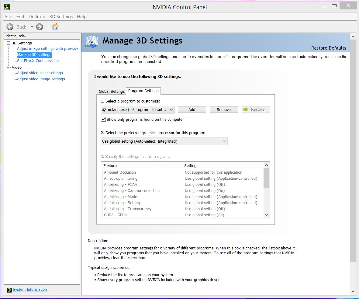

- I dug around in the graphics card settings on this computer and tried to add Octane stand alone to the preferences tab. In theory it should have allowed me to specifically tell it to use the CUDA card but it does not. It defaults to the Intel card and does not allow me to change it. Screenshot included.

ah, well. just taken a 2nd, more enlightened look onto your screenshot
seems we are already there. this one is not from intel, as i was guessing, but from nvida, called "optimus".
it's the 2nd dropdown there, currently showing "auto-select: integrated".
there should be other options (2 most probably) and one of them should clearly point to the nvidia gpu. you'd then need to activate this for octane.exe (if you use the standalone) and also the dazstudio.exe, so also the plugin will see the card... hopefully
[edit]: and also reading you post a 2nd time, you already told it won't allow you to change this

just found this image on the web:
[next edit]: what about to change the global settings? seems that there must be a similar option too?
