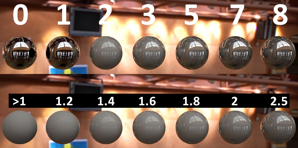

Can someone explain to me what the 'index' setting is doing? I had a notion that it was like an 'angle of incidence' setting. So at zero (actaully I think it's anythign less than 1) this gradient is disabled. but what is it doing after that. In standalone, it goes from 0 to 8, what does that mean? Anyone?
Basically, the higher the index, the more the reflections will distort to the silouette of the shapes, generating a freshnel effect, which is good for metals, porcelains and the like. Chrome/mirror materials work better with index on zero. Planar surfaces like glossy floors seem to work better that way (for me, at least).
The changes are subtle, but noticeables. If you want a more radical freshnel, you should move to a specular material. Here I drop samples of different indexes, and how they affect the reflections, from the minimum to the maximum. The bottom image show how index affects more subtly from a value higher that 1, which almost negates reflections (excepting for a very very extreme freshnel) to some higher values, which makes the reflections more visible . Hope it helps.
