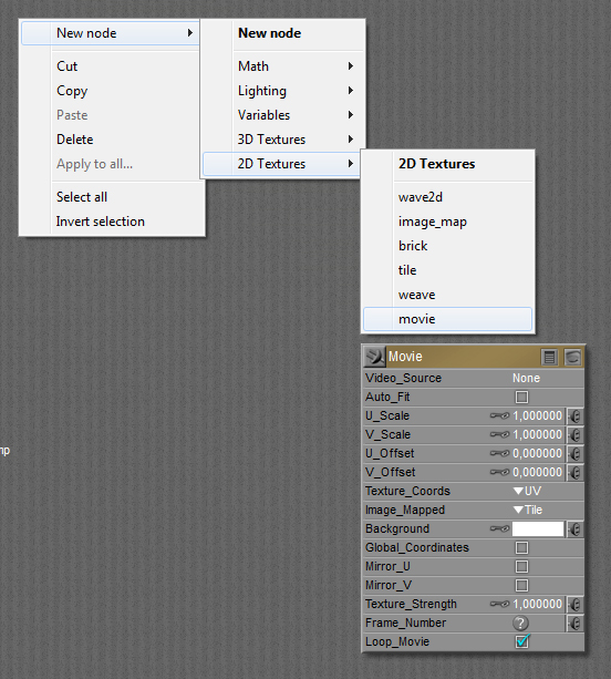

Ah, the movie node. Yes, I've experimented with this node. It's using AVI, which is not really an image sequence, and Octane cannot decode the image at a certain timeframe. If Poser supported a true image sequence (ie. image01.jpg through to image76.jpg for the first 76 frames) like C4D, lightwave, etc, then this function could easily be added to the Poser plugin. But without that it is complex - and the plugin needs new screens to allow the user to specify the image sequence. It's on the list of enhancements to add, but unlikely to be done for a couple of months.

hmm poser can render with jpg sequence if i use this node, i'm sure.
So where is the problem, octane ?
Can you show me an example pls?hmm poser can render with jpg sequence if i use this node, i'm sure.

I discovered the node "2d texture movie" on poser 9 or 2012 32 bit on windows xp don't work with jpeg sequence BUT
on windows 7 64 bit YES its work !! ... hmm strange maybe is the OS ..
I'm running Poser Pro 2012 on Win 64 bit, and cannot see a "2d texture movie" node. Can you provide a screenshot pls?

Is the same of first post ?!
send me you, your palete 2d texture just im curious ...
I was looking for "2d texture movie"!
If I try to load a jpg into a movie node, Poser throws up an error.
I wonder if there is some sort of codec for converting jpg to a "movie" - maybe that is installed on you 64 bit system.
