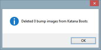

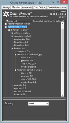

Anyway. Fiddling with some more complex shaders I found that the "Remove Bump Maps" function won't work if you have a little more elaborated bump setting:
Win11/64Bit | GTX 4090 24GB | NVidia Driver 546.29 | Octane 4.05 | DAZ Studio 4.21
face_off
Posts: 15830
Location: Adelaide, Australia
Also, starting the render window collapses the whole material tree. I'm not sure, but didn't that happen in previous version?
It has happened for a few version now, and is necessary.
Let me check this out when I add the "Change floatimage to image" function in a couple of weeks.
