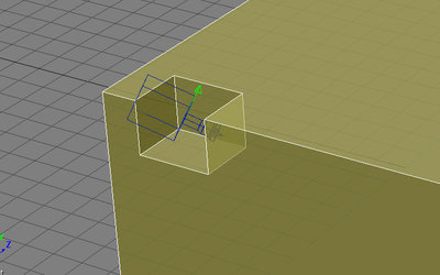

There is a tricky way, i used inside Softimage. For this i need only 2 cubes.
One cube is constrained to the camera position and follow the movement of the camera. The other one is the volume itselft.
Now i bool they together with mode difference and hide the both cubes. The result i get is now a small cube where is nothing, inside a big cube, where the medium is.
Because the boolean is interactive, at least in Softimage, the result is always up to date if i move the camera.
It is also possible to constrain the direction of the cube to the camera, so the camera is alway looking parallel to a face, but i think because a fog is fade in slowly, there is no need to do that.
I have moved the camera in the example to an edge to show the result.
