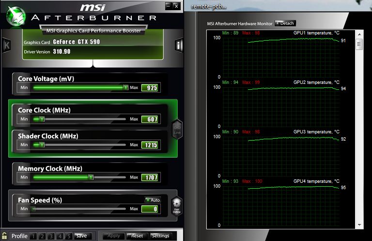

abstrax wrote:
Try re-installing the NVIDIA driver (310.90). Sometimes that helps.
That was it finally the beast is released!
I have been trying to build this system since I first bought Octane about 4 months ago and have spent more than I care to say rebuilding our computers but it still is far less than we would have spent even for one copy of the version of C4D and Vray that we would have needed to do our rendering.
I love the speed of Octane but as we are just getting into rendering it still seems to take forever so upgrading to the 4 GTX590 I know we are getting the fastest render possible. Barring of course the quad GTX690 but I think for the money (4 GTX 590 on Ebay run about $1700.00 as opposed to 4 690's at close to $4000.00) we are holding our own pretty well against The Octane Teams Chris (FooZe) with his 27 benchmark.
We humbly submit our 25.6 benchmark as proof :) Running a little hot though saw temp spike to 100 on one of the cards so we may need to find better cooling.

Awesome, good to see you finally got it going!
100 deg is a little warm :/
NVidia rates them for a maximum of 97 so yeah, additional cooling is perhaps a good move. For the 690's here i managed to cut a few degrees by making sure the case fans were working with the GPU fans to get hot air out of the case.
I can see a couple of options...
1) Try to under-clock them to keep them cool or,
2) Get some serious cooling and then overclock them.
I'm guessing option 2 is more appealing! :)

Whats with the gpu-fan speed? ;)

Yes I am going to have to look into it. I have been told 105 is where you reach meltdown so I think it is too close for comfort. I hate to think about it but I may end up trading these out for 4 water cooled 590s...someday for now I am pretty content. I think that is where the 690s really shine in power consumption and heat but I will wait a while till the price comes down.

I think I had the "user define" on the fan setting off, they were cranking pretty good though. Not nearly what my old 580 classified would. Those things sounded like a jet engine when they were on full.

It is the only way I can render with 4x 580s. Crank it up to 85%.
You know the MSI Afterburner has a yet-engine logo? ;-)
My solution for this mess: Extend a 10m HDMI-cable and USB-cable from another room: Heat issue solved, noise problem gone. I even have more space at my desk at my office. Total costs: 30 euros. (DVI adapters, HDMI cable)
