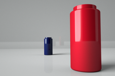

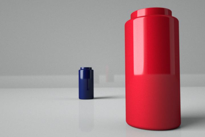

In post NR 5 is picture 21.jpg - 2 bottles - 3 pictures - 3 focal lenghts. 18,34 and 55mm. I added the scene scaled correctly as a rar file. Try it in Octane to get results like in picture 21.jpg with my modeled szene. If you get the goal, i know its possible but at the moment i think octane has some big problems. I tried it yet for hours but MAN...why is this so complicated in Octane or am i too stupid? You have the szene/rar and the picture how it should look like. Please try it by yourself!

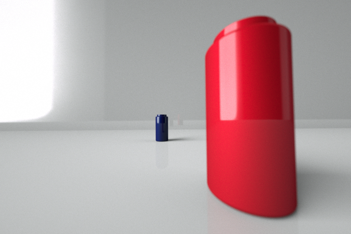

Octane doesn't model fish eye lenses or the barrel distortion you usually get with very wide-angle lenses (note that the right edge of the red bottle is not straight in the 18mm picture). So the images are never going to match exactly.
To get the same perspective your objects need to be in the same position in the render. In your pictures the blue bottle is standing against the wall. In the renders it is some distance in front of the wall.
About the impression that your bottle is a huge building: you get this because the camera position is set lower than in the pictures and it's looking up. An 18mm lens will create a lot of distortion in that case. Put your bottle on the edge of a table and take a picture with your 18mm lens from the same height as the tabletop, you will get the same effect in this picture.

ok, this seems to be right. as roeland noted, the distortion comes from the strange camera position in octane - led me to think that the scale was wrong. you have placed the camera a few mm above the ground, where the real camera is about 10cm above the floor, right?
cfrank78 wrote:I made an object and put it in octane again and the results were the same. Try it yourself. I added the scene as an obj with the 280mm bottles. Try to get the picture and the perspective like in the photo 21 in the earilier post. I really hope you reach the goal and tell me how you made it! I am desperated here!

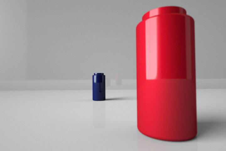

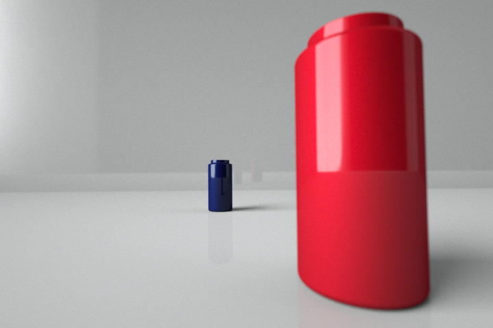

i did it:
BUT those 18/34/55mm numbers are maybe not the complete truth either; what is the crop factor of the camera? here is a page, that calculates h/v fov for some camera types, and you'll notice, that the actual field of view is pretty different depending on the sensor: http://www.howardedin.com/articles/fov.html
anyway, you will still not get a perfectly matching result for wide angles, since octane has no zoom lens ;) changing fov only shifts the perspective. octane is like a fixed lens, where you can artificially change the field of view (what a real camera can't do). to match wide angle photography, octane would need to have another camera model.
cfrank78 wrote:Also......how did you get this strange numbers? 111 and so on. Which plug in do you use? When i google and calculate the Full Frame 28x36mm Sensor at 18mm it gives me 99,34° angle, not 111,1. But nevertheless - 99 and 111 still make not much difference.
as i said: this "strange" numbers are based on another artificial camera model (from daz studio); i'd only wanted to show, that there is not only one correct number for the horizontal fov, as it is based on a number of factors. btw, the tests were done in daz studio, where i just entered the focal lengths above. i did another series using a crop factor of 1.5:
imo these are matching the original photos better; of course still not matching the distortion for wide angles...

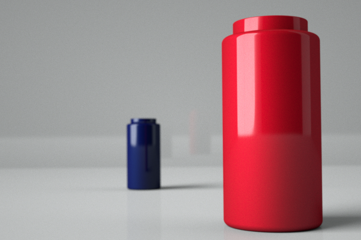

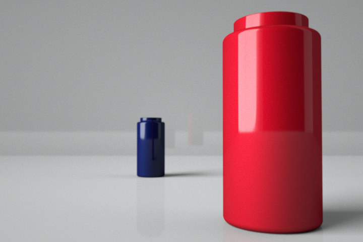

T_3 you made the pictures. Thank you. But the "horizont" in your picture is straight. The original pictures in post 5 are not straight, at least the horizont. Have a look. I made my pictures exactly like the horizont was. I placed the camera so that the horizont and the object itself were like on the picture. The 3 pictures were made with a full frame camera 24x36mm.
