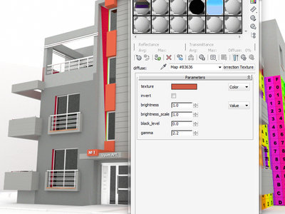

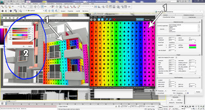

Color is incorrect!
1 - I used a texture image.
2 - standard color.
I tired to pick up the settings for "response Linear", but these are very close to the standard. but I could not get it right transaction! I'm even afraid to make active the sun
just not offer to use textures instead of the standard colors, you know them a little limit ...
the fact is that I am using "RGB to Color Name Mapping (Triplet and Hex)" and the colors do not match, how can I use different settings "response".
But this not only in this version!
white - white thanks though, would be for it

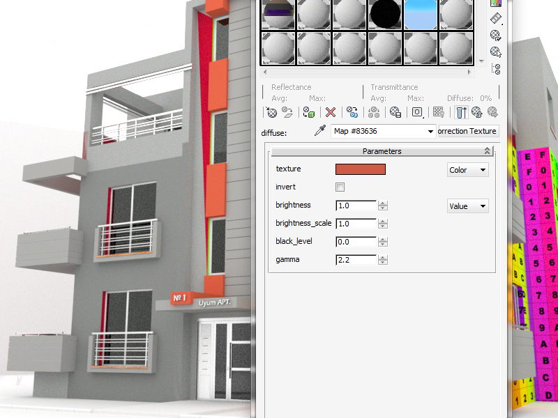

you can use "Color Correctiom Texture" using gamma 2.2, but this is not entirely correct.
2 - standard color.
Core i5 76o @ 2.8o GHz | ZOTAC gtx58o AMP 1536Mb | MSI gtx46o 1o24Mb | Corsair ForceGT SSD12o | Gskill 16Gb RAM 16ooMHz
OctaneRender® for 3ds max®
Did you correctly configure the Gamma/LUT in 3dsMax ?Vanya wrote:Color is incorrect!
2 - standard color.
I tired to pick up the settings for "response Linear", but these are very close to the standard. but I could not get it right transaction! I'm even afraid to make active the sun..
just not offer to use textures instead of the standard colors, you know them a little limit ...![]()
white - white thanks though, would be for ityou can use "Color Correctiom Texture" using gamma 2.2, but this is not entirely correct.
I mean : enable it, set gamma to 2.2, check Affect color selectors.
