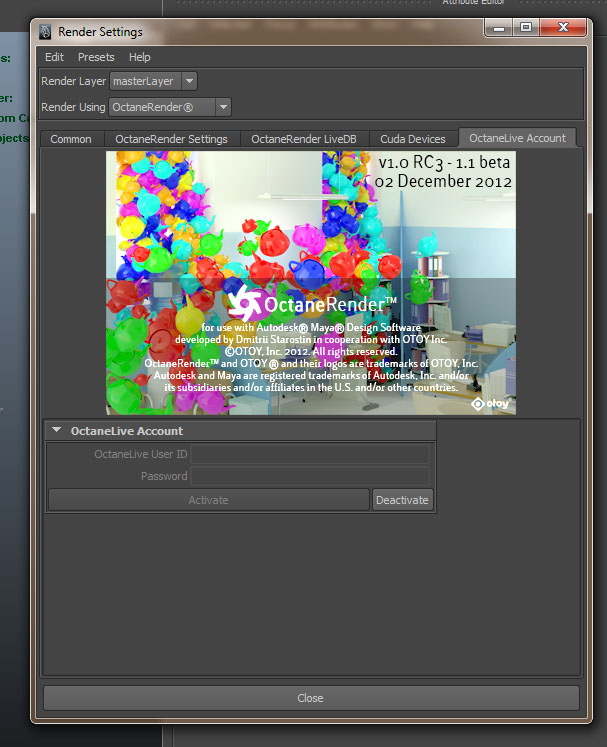

- Have you the same activation errors right after Octane is started?
- What do you see in the "OctaneLive Account" tab of Octane settings, can you make the screenshot?

Jimstar,
There are no errors on Octane startup .
Renderview and IPR work perfectly.
