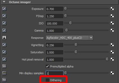

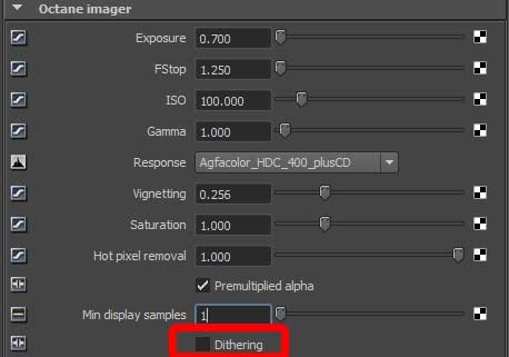

RickToxik wrote:-dithering
:shock:
Where in Octane settings have you seen it? :?
RickToxik
Posts: 140
Joined: Fri Jan 13, 2012 9:22 pm
Location: Canada
hehe
dithering is an option in the camera tab.. hummm my camera tab :)
I'm still not sure how to tweak the swatch quality, but I guees there's no need to go beyond the default 32? Thanks!

RickToxik wrote:dithering is an option in the camera tab.. hummm my camera tab :)
Yes, it is one of the Imager settings...;)
