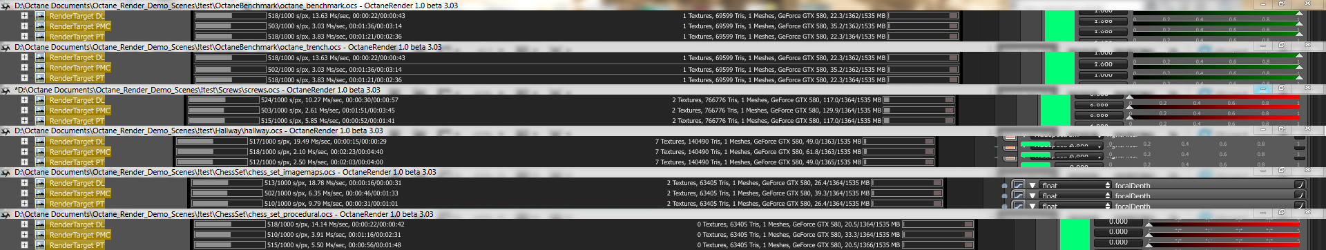

Hi. This is my experiment in 3.3 version.

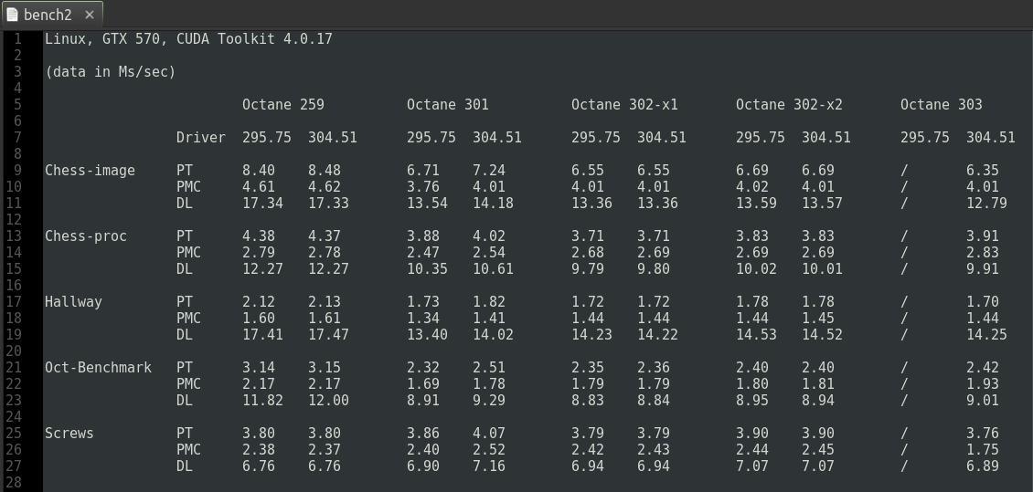

Updated benchmark, now with the latest stable Linux drivers 304.51
With the new drivers, compared to older 295.75:
* Octane 259 gains in speed just slightly in some cases
* Octane 301 gains in speed quite noticeably
* Octane 302 x1 is exactly the same as with the previous drivers
* Octane 302 x2 is exactly the same as with the previous drivers
I didn't benchmark 303 last time
