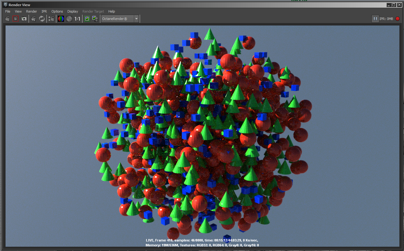

RickToxik wrote:I also believe that the particle instancing only supports one object per instancing at this moment, I guess you already know that / supposed to be like that. I am away from now but I was not able to instance multiple objects with one particle instancer last time. Cheers!
Yes just checked this and octane seems to grab just the first object in the instancer list. (depending on how you have the objects set up to cycle it could pick a different one per frame but it only ever picks one for any given frame and doesn't distribute them the same as the instancer node does in the Maya viewport)
