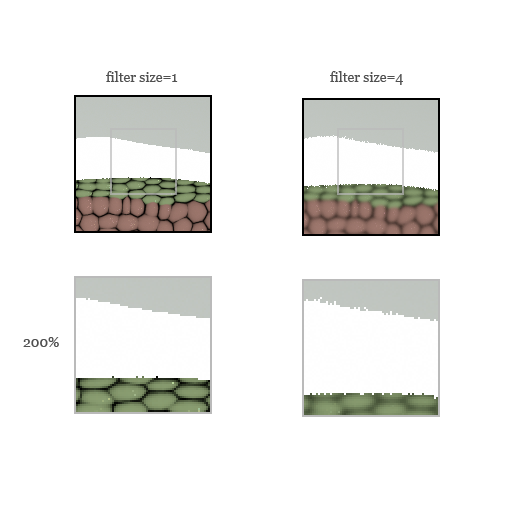

I was going to point out that; Vray does have a solution for this, even if it means losing ranges beyond 255. The sub-pixel option you mention, caps all subpixels that go beyond 255, so the resulting pixel does not outshine neighbours.
Also, with the introduction of glow/glare, overbright areas get some glow that does spill to neighbour pixels to cover up this jagginess... when it was introduced by Chaosgroup they pointed out glow could be used to address this.
Grabriele, the problem lies with sub-pixels being out of range, and creates such a contrast with neighbouring pixels there's no filter size that can smooth that (without smudging the whole image that is - see edit) The only realistic solution is to be very careful on not using too powerful emmiters that are visible from camera/reflections... if the scene allows. If you HAVE to have such powerful emmitters and they are in the shot, you're out of luck.
edit:
This is a little test of what happens in overbright areas even if you raise the filtering to 4. Results: completely blurred render, overbright pixels get scattered by filtering.
edit:

ok now I understand what you mean, antialiasing doesn't work on overexposed objects (mesh emitters)
Probably a clamp tool could help, I always used it in vray + subpixel mapping.
