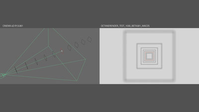

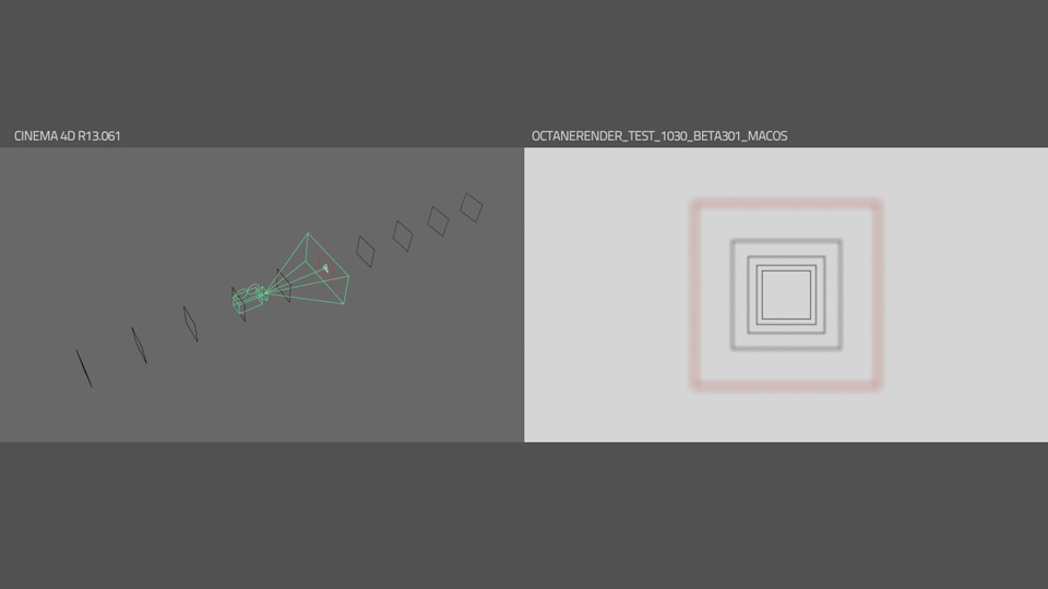

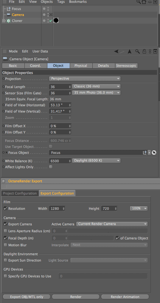

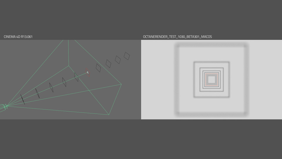

Hey guys,
Firstly, thanks Marcus- I've been playing with the new exporter and it is awesome!
I've come across an issue-
The Focal Depth is not coming through correctly when using a Focus Object (during animation)
The initial value seems to stick throughout the entire animation, rather than updating for each frame as expected.
If this a bug? can anyone suggest a workaround for the time being?
See attached if my explanation isn't very good.
First frame (correct focus in Octane)
Red square should remain in focus
Settings
Settings

That definitely looks wrong. I will have a look at it. Did you use a different render target than the preview render target?

abstrax wrote:Did you use a different render target than the preview render target?
Marcus
I've just been using the preview render target.

The problem with the camera is that the focus distance field of the camera object doesn't get updated, if the scene is not displayed in the editor (i.e. redrawn). You can check this by hiding the editor view. I will have a look how I can work around the problem.
