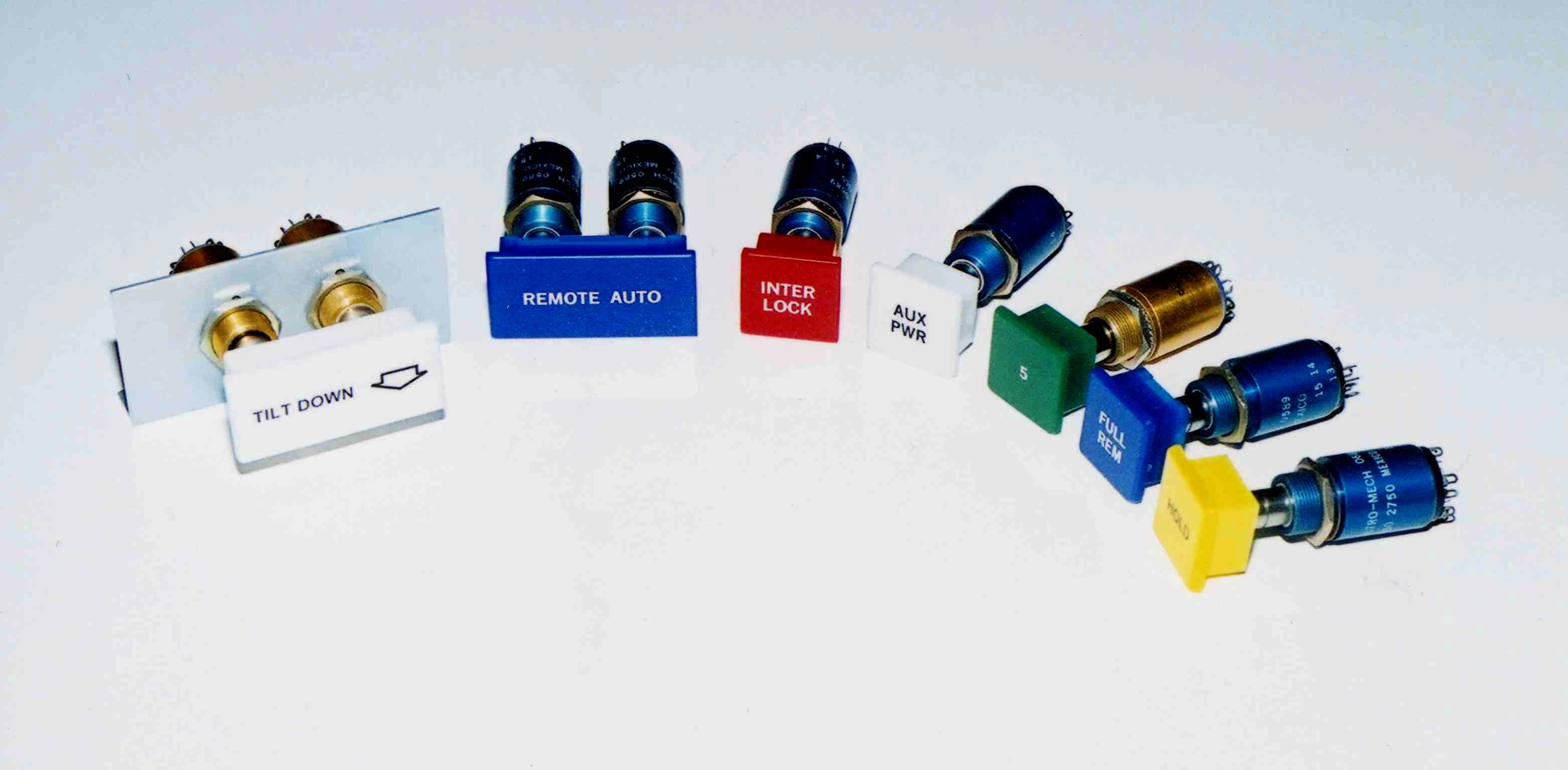

By the way, here is an image of the type of pushbuttons I was trying to simulate:
Emitter plane and backlit pusbuttons
Oh, i see, yes these are different to what i had in mind.

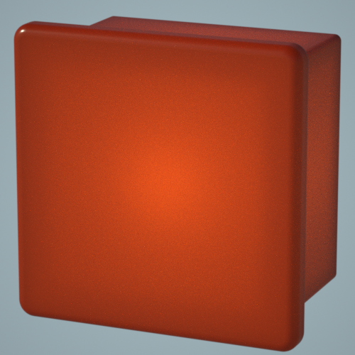

Here is what i came up with when going down the mix material road, glossy combined with the specular.
Note that i also changed the emitter to be a bulb shaped sphere and changed the plane of the old emitter to be a highly reflective surface. Hopefully it's more along the lines of what you are after?
I think in this case it's just that scattering is not as effective as just a high roughness. I didn't write the code so I can't comment on mathematically exactly what it is doing but it would seem this initial interaction on the surface spreads things a lot more than scattering does, without diminishing light intensity.
I think this ties into your problems with the color of your lights too - because you may be needing to increase the light intensity to compensate for the scattering. As you increase the intensity of an emitter, you will probably have noticed that there is a clipping point at which the light seemingly becomes over-exposed and starts to increase in temperature. So even a red light source, with excessive power, will start turning white (and travel through orange on the way).
This is definitely not an easy material to simulate!
Cheers
Chris.

Hey, thanks for the post and the great image. That's EXACTLY what I was trying to achieve. I also like your idea of having that highly reflective back surface to help "push" the light forward.
However, on the red problem, I can understand how the color temperature increases with power and tends toward the oranges and yellows, but if the material of the plastic is red, then it seems that the yellow wavelengths should not be able to pass through the plastic. In other words, the light getting through should only be the red wavelengths. We've all seen a red pushbutton, and the lamp is putting out a lot of power without there being any yellowing at all in the illumination, like these:
There HAS to be something wrong with the way red is handled. I can lower the power back to almost zero and I still get orange to yellow. If I cut the distribution back to near zero as well, it does not seem to go as far into the yellow as before, but still very orange. That just isn't behaving naturally.

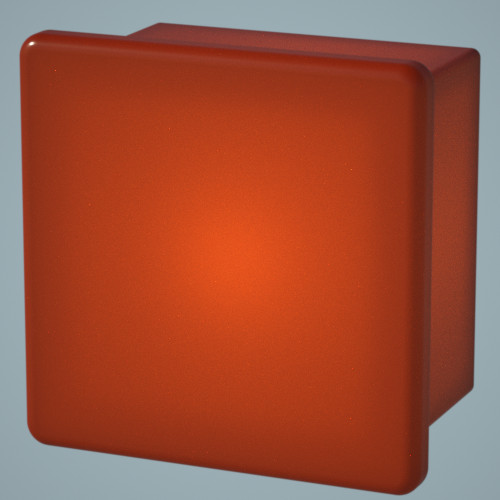

Hi, Sorry for the late reply.
Sorry, i can't remember the render time - i just left it while i was checking emails/working on website stuff and being generally busy
I think at the time i was using a single 580, however i have 2 in my machine at the moment.
So this was about 3min on 2x580's ...Hotpixel removal at about 0.45, alpha shadows off.
Note this one is a png, I think conversion to jpg (as i did for the last one) tends to smooth the image too.
Cheers
Chris.
Cheers
Chris.
