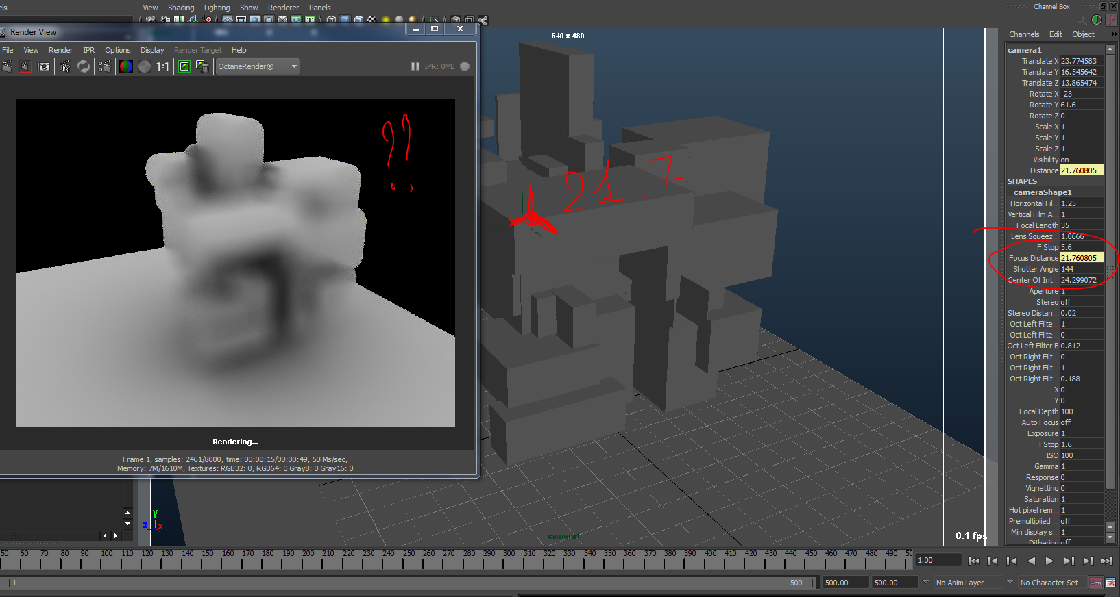

During the IPR rendering just select "region" on the RenderView that you want in focus (that works in IPR mode only). Otherwise - just set "Focal depth" attribute of Octane camera.Joss wrote:Is there any documentation for Maya plug-in at all? Installed it, but now i can't understand how to control camera focus distance, and i can't find any clue of where to look for documentation...
I have a script that creates focus distance locator so i can move focus all around the scene where i want.
In my scene distance is 21.7cm, and i'm getting image totally out of focus.
Also it seems with alpha channel/alpha shadow options on, image in render view is unpremultiplied.
See attached file.
See attached file.

Ok, found that there's plenty of new attributes added to camera AE template, and there's "premultiplied alpha" attribute that with those two options in renderGlobals produces proper image with proper alpha.

Problem with focus is still here. Testing with autofocus=on at the moment, but i'm not sure it's ok.

Yes, Octane has its own camera attributes set, I already wrote about that for focus: "Focal depth".
