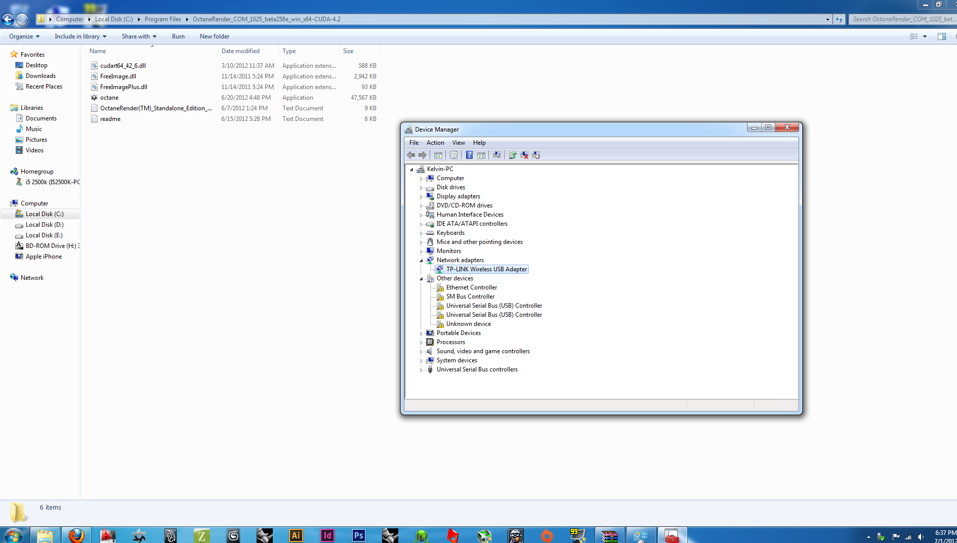

I just checked the device manager and thats the only network adapter I am using, It was working before this using the same wireless USB adapter. It's really strange that it suddenly stopped working? sigh..
							I7 2600k | EVGA gtx 680 FTW 4gb | Win 7 x64 | 16gb RAM
						Hmmm its strange that Octane still works on my laptop using the same connection tho? Anyways ill be getting a Netcomm NP504 500Mbps Powerline Adapter Tmr so we will see how that goes. Still a very strange issue tho hmm...
