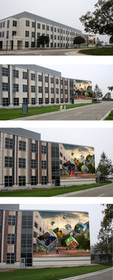

Thanks Proupin
Saved my bacon... have to do a wall.... and was wondering how the heck to do it big enough...
Draft attached
