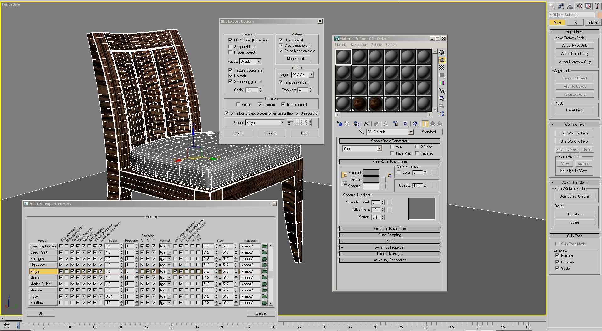

I am using max to export objects and have no problems except with smoothing groups.

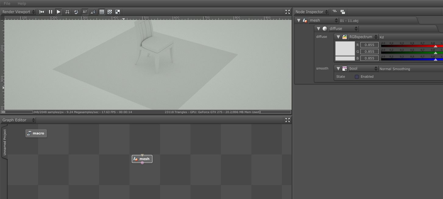

in octane object are grouped by their materials, you can have 100 objects in max but if they all have the same material they will be considered one object once imported in octane.
3ds max obj export
It importet the texture map for me now. Got a mesh error that i have to sort out. I will make a little tutorial for the obj export settings

I tried the Maya preset like "Radiance" said... still just one material.
sam75: I have 4 different materials in the max scene.
Chris: Very strange indeed, Also I notice if I dont convert my object to Editable Mesh... I have alot of strange triangulation
Convert to poly also gave this strange result, not allways dohpedrofelipe wrote:I tried the Maya preset like "Radiance" said... still just one material.
Found out one thing regarding the textures. The textures you are going to use in max, put them in one folder. When you export to obj, save that obj file in the same folder you have your textures that you asigned in max. That should solve the texture problems. I`l give you settings for export in just a sec that works for me

Heres my OBJ export settings:
Put textures and OBJ file in same folder, use a standard material with only one texture. If you do that i see no reason for it not to work

tried exacly that you said... and still only one material on octane!
very strange. You have checked that you havent grouped your objects either?pedrofelipe wrote:tried exacly that you said... and still only one material on octane!

Chris wrote:very strange. You have checked that you havent grouped your objects either?pedrofelipe wrote:tried exacly that you said... and still only one material on octane!
Yep, they are exploded. would you send me a .zip with a scene and textures? dummy stuff? [email protected]. 3ds max 2009 sp1 64bits here!
