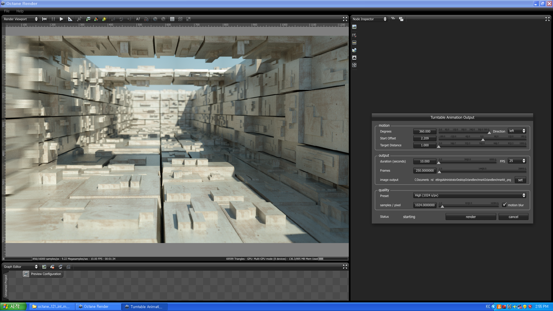

0.5 GTX295 = 1.48 msps (+1.48, 1.00x, 100%)
1.0 GTX295 = 2.77 msps (+1.29, 1.87x, 93.5%)
1.5 GTX295 = 4.14 msps (+1.37, 2.79x, 93.0%)
2.0 GTX295 = 5.41 msps (+1.27, 3.65x, 91.2%)
2.5 GTX295 = 6.71 msps (+1.30, 4.53x, 90.6%)
3.0 GTX295 = 7.81 msps (+1.10, 5.27x, 87.8%)
3.5 GTX295 = 8.61 msps (+0.80, 5.81x, 83.0%)
4.0 GTX295 = 9.33 msps (+0.72, 6.30x, 78.7%)
Very nice scalability !! :)

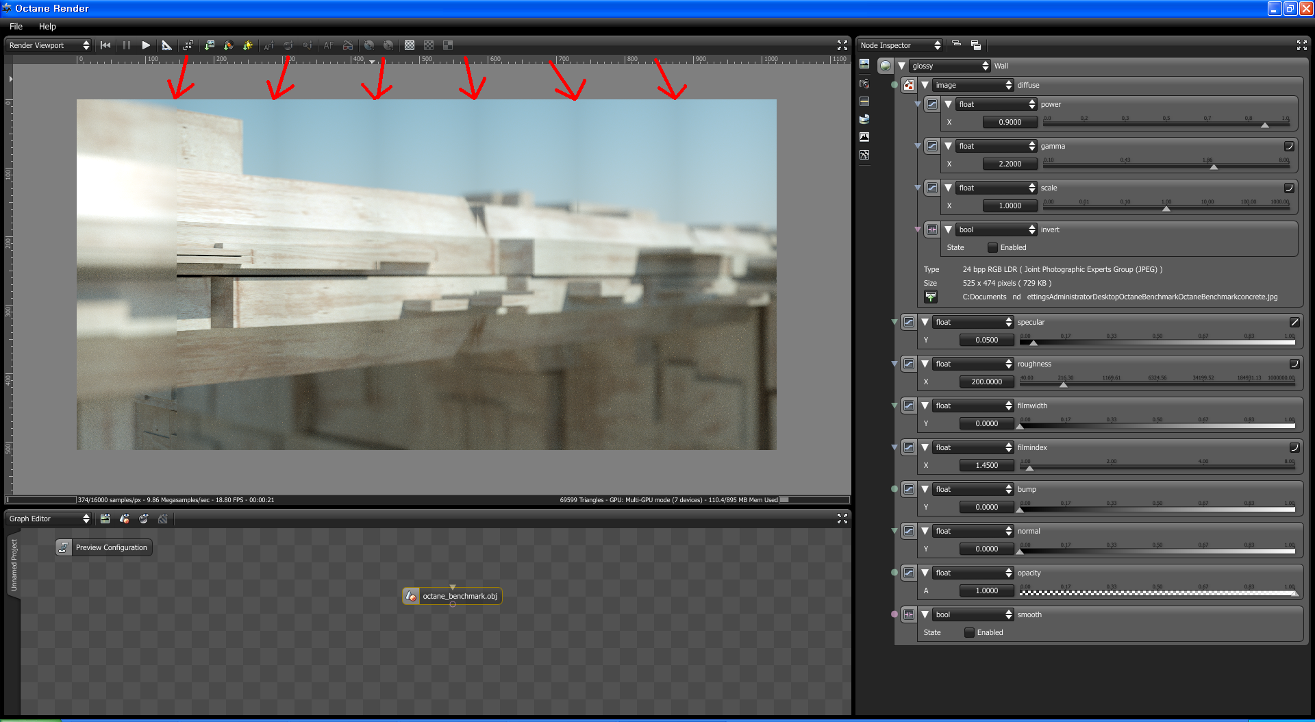

Two bugs regarding video buffers,
1. Connections between video buffers are not continuous.
2. The first video buffer (from the left) is dimmed.
And, when I switch between 'daylight' and 'texture environment', Octane is crashed.

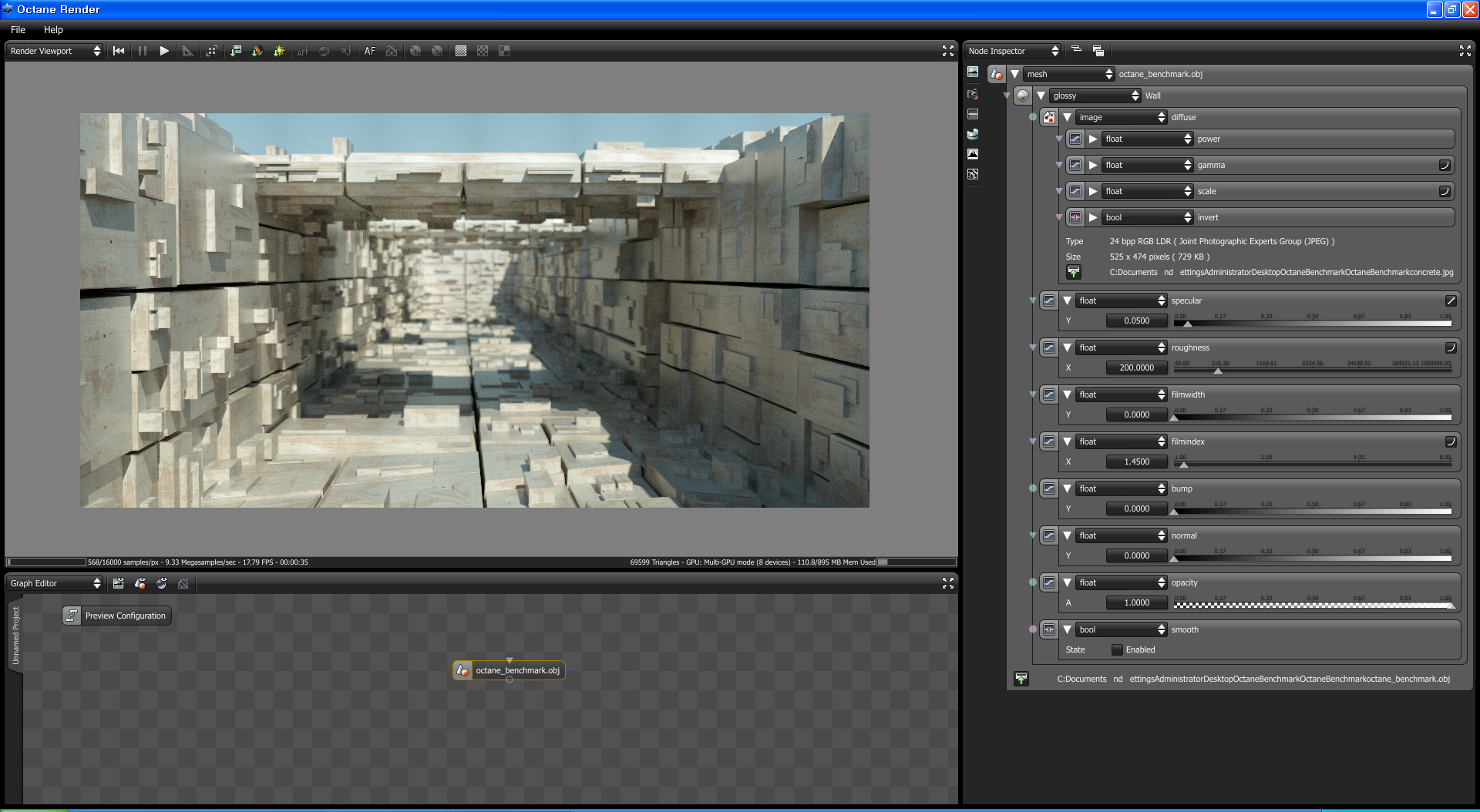

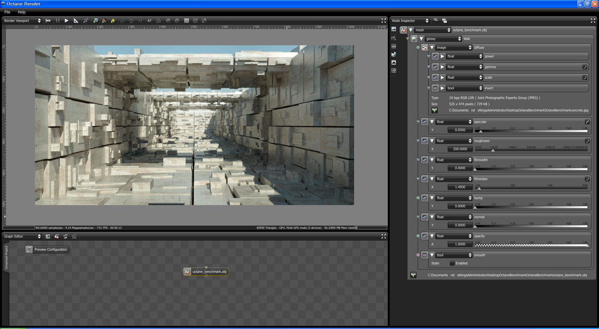

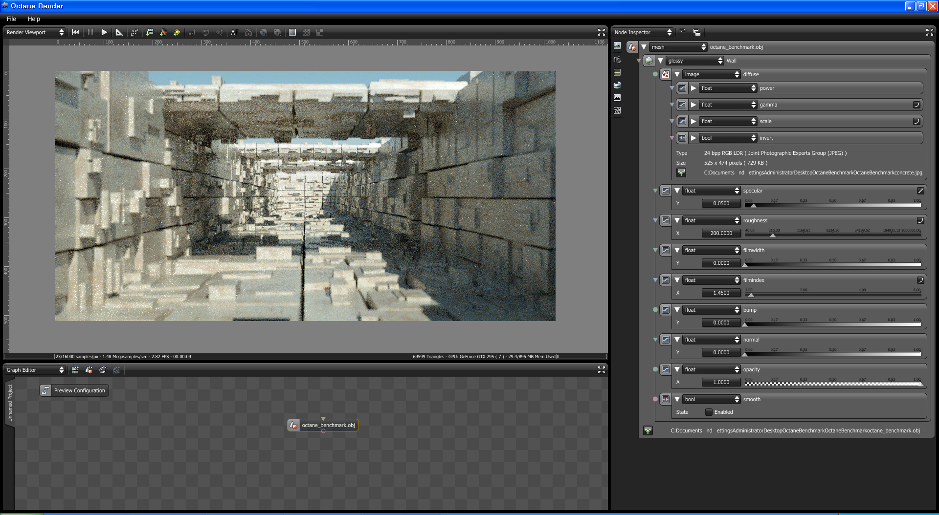

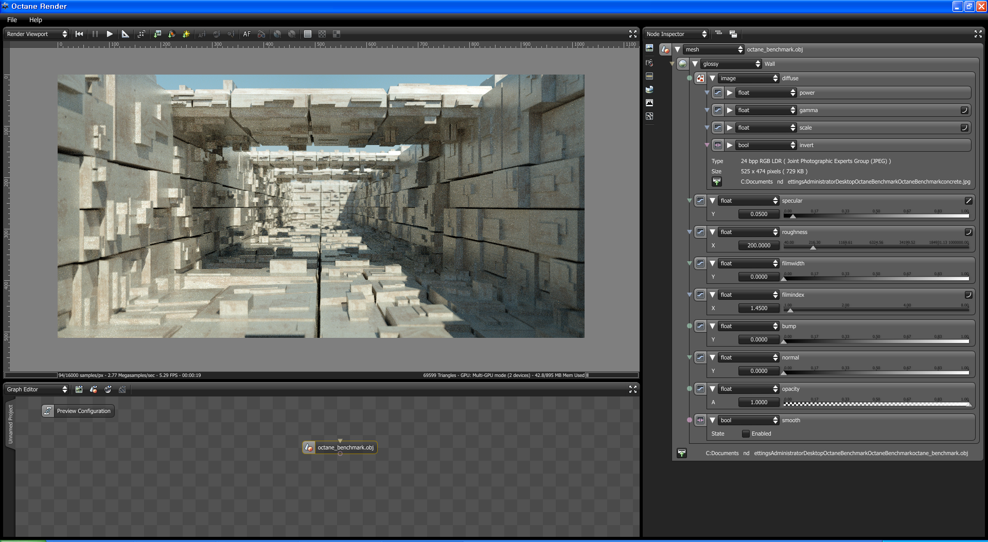

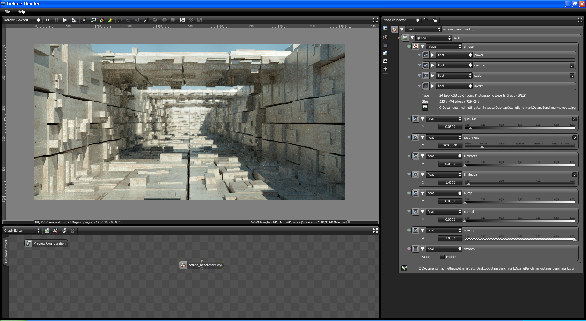

andrian wrote:There is something weird, or I do something wrong, but seems I get higher samples with first single GPU than with both...
And what about memory usage?? It's double in multi GPU mode. I know that have to be loaded in both GPU-s.. but that way seems i have left less memory than with one GPU scenario. Also some weird line in the middle, separating both GPU calculations in multi GPU mode. Renders was done with pathtracing kernel, scene is saved in Octane beta 2.1 non multi GPU version. No material applied to any object ( uses the kilaD scipt to export ).
Hey,
This is indeed very strange.
we'll look into this and we might ask you to test again with another executable soon.
Radiance

As I said before, my system behaves in the same way as his.. 8800 gtx and 260 gtx running together is slower than just using 260 gtx,
using latest nvidia drivers on win7 64 bit

that would be normal.
as i explained, this version does'nt yet take into account the power of the gpus,
so if you use a slow and a fast card together, they will both get half the work,
and the GTX260 will have to wait until the slow 8800 is finished.
our next test version will be a lot optimized so you should try again with that one.
Radiance
