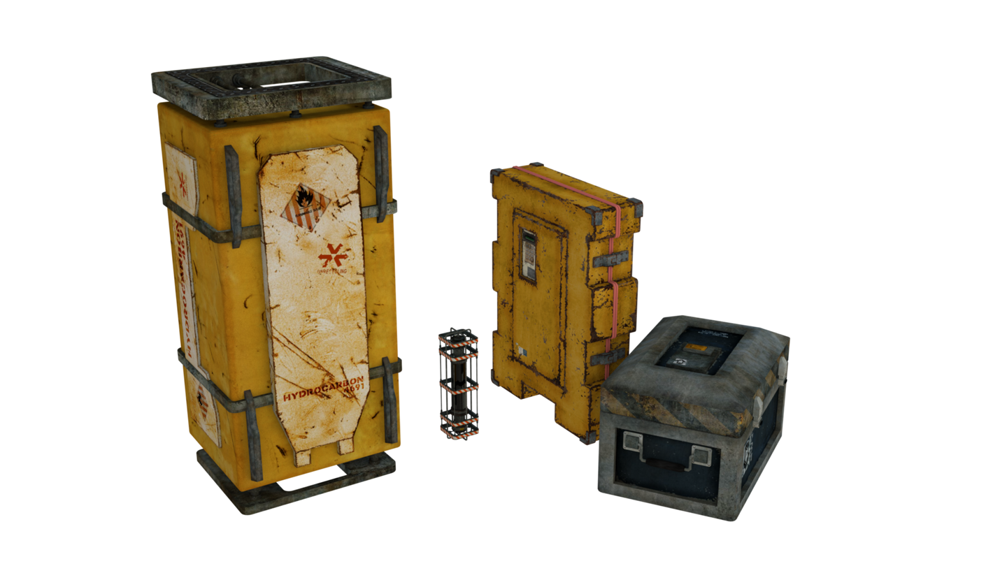

Thanks for taking the time and thanks for the explanation. This does help. I found if I setup my lighting and ALPHA in the BLANK.ocs file, it helps. Here's an example, after I replaced all of the textures with the original DAZ textures. I also used a GLASS texture from Octane. 8-)
