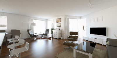

interior test, 1 hr. using a 250 gts... exported from LW 9.6 and rendered in Octane, original rez 2048x1024
using 480 mbytes memory.

Hi Roger,
Nice interior shot.
I am a LW 9.6 user as well, so I would like to ask you how do you export your scene from lw?
did you export from modeler or layout? if it is layout, what did you use as obj exporter?
Héhé, I know these are a lot of questions, but I can't get a mesh with all of my materials and textures from lw so far

Hi! Pixym
This is my method...
1: first of all, UV-map all your textured objects in LW modeler. I just call all my maps "UV"
2: load your scene into layout.
3: export your scene as collada.
4: import your collada scene into modeler. all objects into 1 layer.
5: export your object/scene from modeler to wavefront. if you texture everything in modeler, modeler makes automatic UV's for your object when you export from modeler as OBJ.
6: put all your textures into the same dir as the obj-file
7: import into octane, place cam and render..
