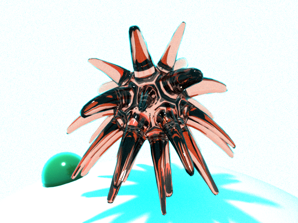

Joss wrote:1. about env color again: maybe it would be more logical to take background/env color from current camera's "background color" attribute?
No problem technically, but: in this case we become some ambiguity of "what for "Power" value to set for that default environment texture with that color?". If texture is black, no problem, the "Power" gets just "0.0" and we get the black environment.
But if you have e.g. some "light blue" color in camera background - then the value of "Power" attribute in that default Octane texture environment becomes heavy impact on resulting environment color and entire scene lighting at all. As in these images, it may vary from "dark" to "very light" if some different values of "Power" are set (and the resulting brightness with the same "Power" will be different for different colors)...
So, setting the color from the camera background is some ambiguous in choosing the right "Power" value for that background color value, needed exactly for your scene... As camera does not have the "Background power" attribute...;)
What value you think it should have by default?
What others think about it?..
I think, that for the case of lack of SunSky node in a scene, black default environment texture with "Power" = 0.0 is more univocal...
