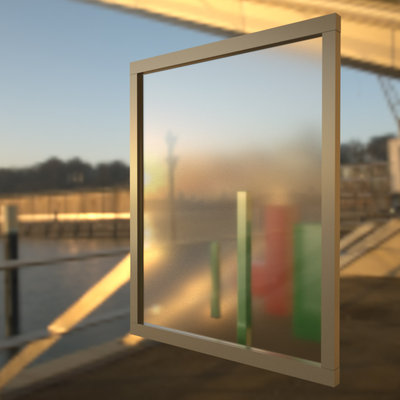

thank you for all suggestions.
The best and semi-exact method is to enable the scattering and tweak the scale factor. I noticed that the scattering operator doesn't blur specular highlights on objects that stay on the back of thin glass panels.
For example: create a thin (1cm) glass panel and enable the scattering. Put on the back of this panel two objects with strong reflection, you will see clearly the highlights on these objects seeing through the glass.
The second "fake" method is to mix two materials: 0,9 for a specular mat and 0,1 for a glossy mat with fresnel reflection and glossy=0. In this case we will get two reflections, one blurred and the second one sharped.

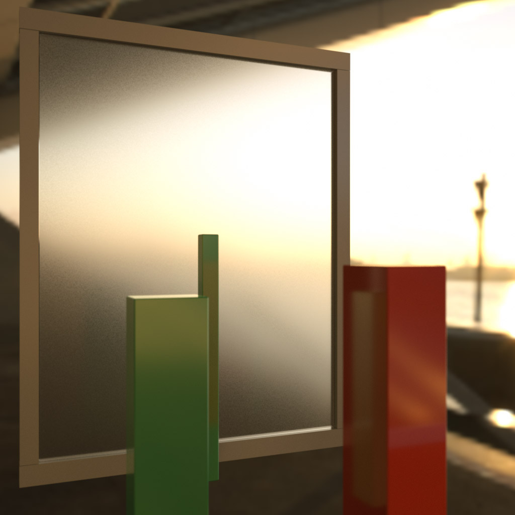

I have tested this but couldn't reproduce the problem.
This is just a box with two specular materials applied.
