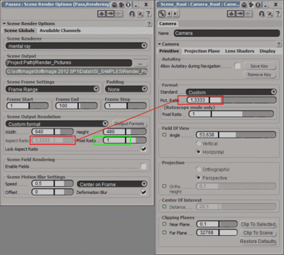

i've not used octane in a long while and am just getting back to it with the current exporter but the camera always seems to be a little zoomed in wich is a nightmare for comping with other MR passes - and for my workflow that is a must.
I'm just using a plain old perspective camera (on a path) - that should just export correctly right? I seem remember last year it worked fine... :?

Have you set the pixel ratio in the Softimage scene render options to 1?
Copy also the new aspect ratio to the render Camera.

Yeah i had the aspect ratio matching and pixel ratio at 1, i even tried an aspect ratio 1,3333 (had it at 1.7778) but if anything that seems to have zoomed it more...
I can send you a scene if you want?

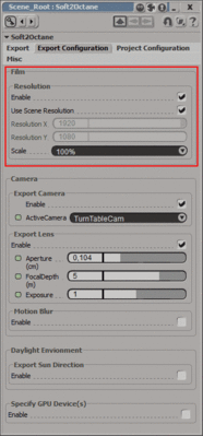

Ok, found the problem.
You must enable the resolution.
If you don´t do this, Octane uses the resolution which is saved with your preferences.

Derp, can't believe i hadn't tried that... :oops: Works fine now!
