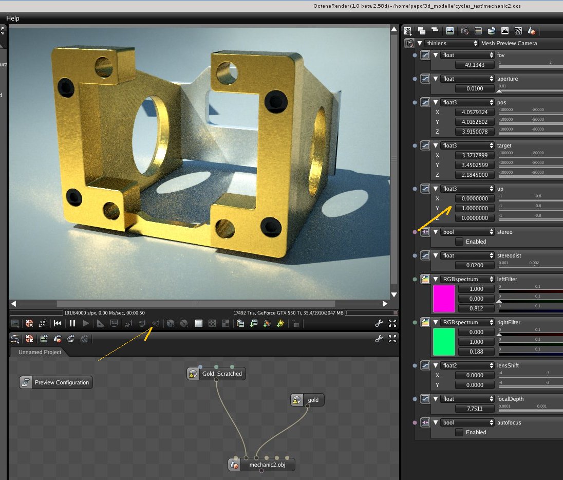

This is often a export problem.
Set camera "Up" to 0 1 0 or use the camera target picker.
Wow!
That made such a difference! Thank you so much ;)

If something exports the up vector different than [0 1 0] we need to keep it that way, otherwise it would be impossible to export a camera that is not standing straight up.
