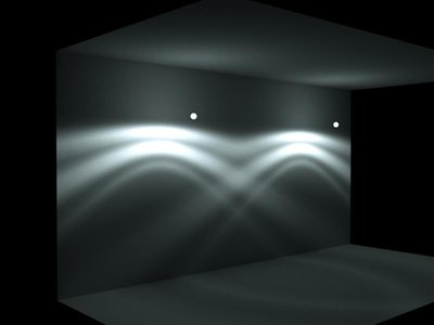

Just tested
Everything works.
Probably you use too low light power so you don't see light from ies.
Do you use Octane camera? In this case imager settings of render panel is ignored.
