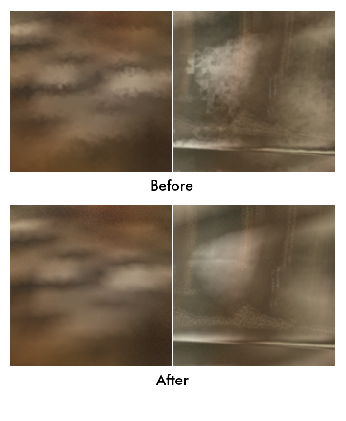

Thanks for the links Jaberwocky and Proupin. And the results are..
MeshLab was able to correct things to a certain extent. It seemed to be able to eliminate the zigzagging, or at least to reduce it so that it was practically gone, but had difficulty healing boundaries between butted mesh areas. Compared to Maxwell's Recalc Normals function, I think Maxwell did noticeably better, but certainly not perfect.
Now comes the interesting part. I then tried Riptide and if I both imported and exported in C4D with it, Octane would hang when the OBJ was imported. BUT...and again inside C4D, if I imported with Riptide and then EXPORTED with OctaneExporter...walla...a beautiful mesh:
and I think this supports my idea that C4D corrupts the normals. Riptide did something to maintain the data quality by circumventing C4D's native import function. Oddly though, it corrupted the export such that Octane would hang and have to be closed via Task Manager. Or possibly, Octane did not properly parse the data when it was imported there. I have no way of knowing either way.
There is however, one remaining issue in all of this, if we accept this whole approach for C4D as THE solution. In looking at the two closeups of the successful Octane render, there is an interesting watercolor quality to the mesh smoothing which I think is an Octane issue:
In the first image, the watercoloring seems to be just that...A watercolor-like texture. But in the second image, it appears that this texture is composed of incompletely smoothed polys.
Overall, things look much, much better although I have not yet attempted including the bubble in a multiple surface OBJ. That's next.

roeland
Posts: 1823
The shading calculation in Octane is faulty. Usually it is not that visible, but for transparent objects like this bulb it becomes more visible. I will make an updated release later today, you can then try if it looks better in the new release.

This is a copy of my response over in the Candidate testing area for the new release 2.58e.
The watercolor look is almost completely gone now. I think it's still there but VASTLY improved. In some spots I don't see it at all.
You can't see it in these images, but the zigzags are still there, unchanged. I really think that is a C4D problem. Especially since I just did another refractive test with another scene, using the same workflow as when the bubble would fail, and it's perfectly fine. This time, the refractive was a solid glass object, not a hollow one. I am going to test the same object but next with a thin surface instead of a complete solid to see if it behaves like the helmet bubble.
I think it is also possible that there is something intrinsically different about the bubble mesh from other meshes. Even though I have re-xported it from Creo, and the vertex normals are exported, maybe Creo did something unique that is difficult to interpret by other loaders. At any rate, Octane has zero problem with the mesh when it comes straight out of Creo. Unfortunately, I can't then combine it with other meshes easily for the single OBJ that Octane requires.
Thank you very much for your time on this Roeland. Much appreciated. :)
