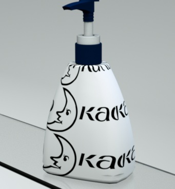

Hi I'm a Rhino user.
I am a new Octane user for only few weeks, and I keep trying~
But, there is a question I can't find the solution.
The question is about logo-placement.
I made a simple model and try to make it like "real", so I put on a logo(png. picture).
It shows a lot of logo(repeating), I don't have any idea to control it?
is there any way can let me put on the logo on the right place?
Or...did I miss any step to apply logo????
John
Logo on Surface
- Attachments
- 003.jpg (22.55 KiB) Viewed 3379 times

In Octane you haven't decal feature. You can't deactivate the tiling.
This is valid in Octane for Max too.
I requested this elemental feature.

Scale is the only mapping thing you can control for image textures, so you will have to properly UV map the texture in your 3D app.
Yes, we need translation / rotation / mirror / multiple UV per texture, the whole lot...!

you can make a rectangle surface 0.1mm offset above the model and place the logo there...
you can make the canvas of the logo bigger...
you can slice a rectangle of the model and place the logo in that slice...
i try to write this in english
or do a UVW unwrapping of the model, save the unwraped skin and paste the logo onto it in photoshop, like you usually do in most 3d poly based software.. (ok not all apps have the uvw thing)

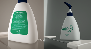

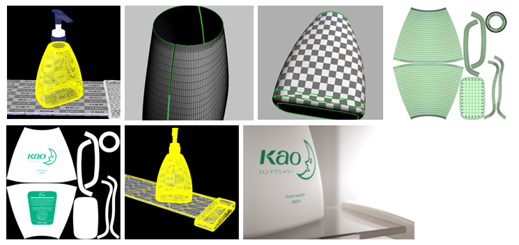

Hi gabrielefx / matej /aptoverde / acc24ex
Sorry for late reply,
I've made some study about UV unwrap after having feedback from you.
Now I'm glad to share how I make it~(basically follow acc24ex's suggestion)
1) UV unwrap:
Export obj file to make unwrap, I used "HEADUS-UV LAYOUT" in here.
Cut and separate the obj and unwrap it.(you guys must know that, I skip)
Rhino has it's own UV unwrap tool, but UV Layout is really useful, I like it!
2) Export UV MAP
Export tif or Jpg format picture from UV Layout then open it in photoshop.
Then I Put the logo on the place which I wanted to.
Clear all background except logo, save file.
3) Import to Rhino
Import to Rhino, then check UV.
Name and export all objects for the scene.
4) Octane Render
I directly change RGBspectrom into "image", then select the UV map I just created.
The logo will show on the right place which I arranged in Photoshop.
Thank you guys again~
have a good day!
John Yen

looks nice
yup.. that's how to do it properly
, glad I helped
just thought about it and realised another approach would be to cut the place where you want the logo and set that part as another texture and then apply logo to that part, the topology isn't nice after that, but with uvw layout you have complete control
