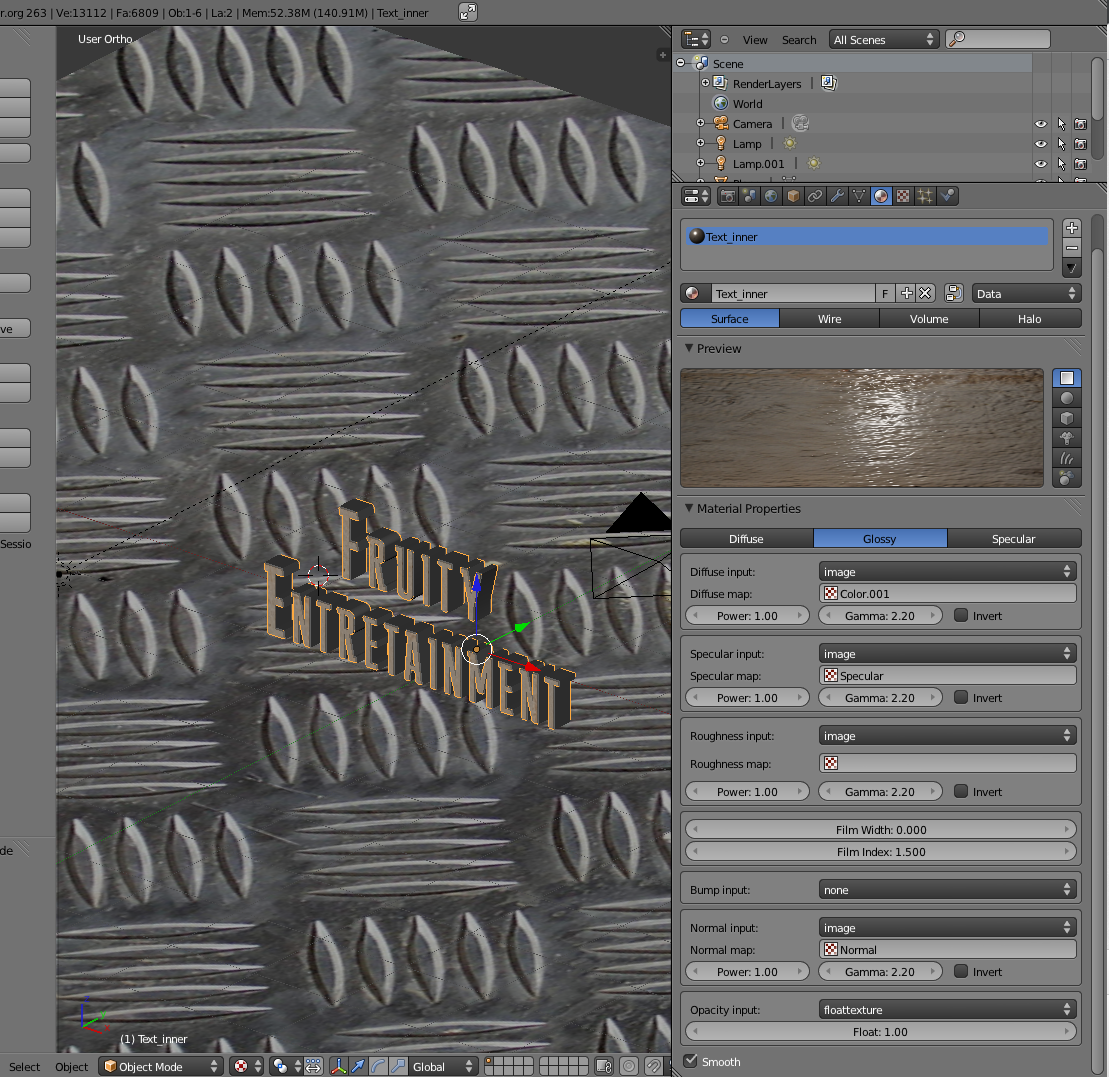

when using the exporter (1.19) i get this when importing into Octane
I do not know what the problem is.
there are three object in the scene.

Hi, I don't understand your problem : You say no texture applied, but your material shows a texture. Please be more precise.

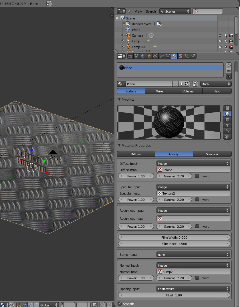

@roubal... he means object 1 has no image, object 2 has images as per attachment, object 3 has images as per attachment.
@ larmannjan... I notice that for Objects 2 & 3, roughness input is set to image, but there is no map listed in the text field. If you do not actually have a roughness map set input type to none. If you have a roughness map either it is not selected or not actually available in blender. Hope that helps.
