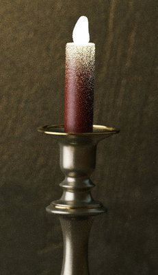

Right now I'm rendering some candles and the SSS region around the flame is complete noise garbage, while the rest of the render is already clear (even DOF). We need a sampling brush feature inside Octane or a way to load a "sampling intensity texture" painted in photoshop/GIMP, which would tell Octane in which areas to concentrate more sampling.

I haven't any problems with sss
don't use pathtracing.

Yes PMC will give better results for SSS, but is actually slower than PT for everything else. Though this is not the point of the thread. Sampling could be optimized for some regions, be it automatically (DOF regions, for example) or through user input.
