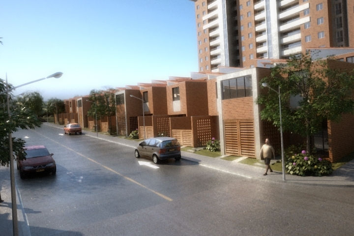

This is my first video with octane render pluging 3dmax, please make your comments.

Nice =) give us a bit more info about production, pls =) anything!
As for c&c some materials looked a bit flat =) but..it's livable(i do understand that this might be for optimisation..
one thing that was a bit too hard was camera movements - sometimes bit too edged - work on that to get more fluidity, sometimes this distracts more than any material or other issues =) appart from that it is really beautiful work!
Have no idea how you managet to put su much geometry into 590s =) please tell us more.

Nice job! Please tell us where you got the trees and plants. Thank you!

Could you provide the render time a frame. I assume it literally must be seconds with the amount of CUDA cores you used for.
very nice work..how many polys did you have in the scene ?

you need to tell us the rendertime per frame
THANKS FOR YOUR WORDS.
The polys in the escena have a 7.000.000 vets 9.000.0000
Annex a picture for the screen.
The trees is a model from Evermotion Archmodels, but optimized in 3dmax, the original tree have a 300.000 polys but the modifier ProOptimizer, the tree have a a 30.000.
The frame is a two ways.
1. When is actived the Update animation geometry the render is 2:30 or 3 minutes.
2. When is not actived the Update animation geometry the render is 40 seconds.
Remember is for one computer 2 gtx 590. I have 2
Path Tracing - Max samples 1500 - Maxdepth 6 - Is simple DayLight.
