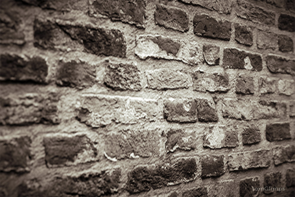

..also You can always look around to buy few good maps in decent resolution to give You just enought details (those usualy have not only bump and diffuse, but also spec and even normal =) - they usaly don't cost so much ~ 5$ is enough to find something nice.
i was testing today a brick wall for one of my projects with the maps i've bought a while ago, pretty happy with outcome: take a look if it's interesting for You.
