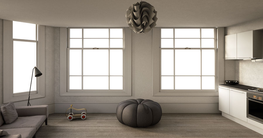

sdwhitton
Posts: 126
Joined: Sat Oct 15, 2011 5:26 pm
here's the render btw..

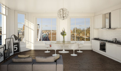

sdwhitton
Posts: 126
this is how it's turned out in the end, well nearly, need to add some glass, maybe over-expose the exterior, and make the sofa look less 'greasy'...
just switched back to Ambient Occlusion, with a sun...
see what you think,
cheers
Steve
