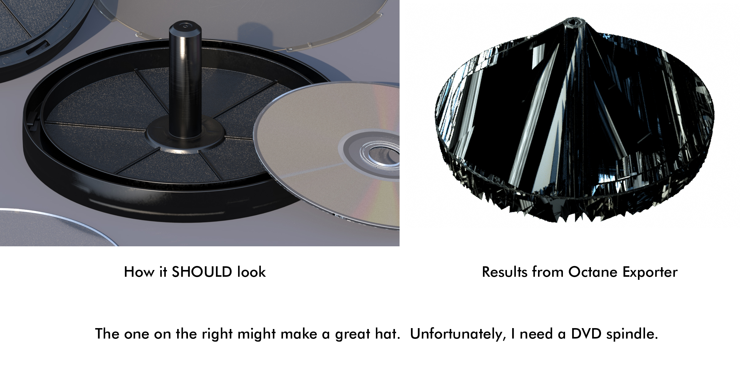

4. And my favorite...The OctaneExporter from Holocube:
I was hoping to use Octane on a job I have going, but I think I am going to have to go a different route until this LW/OBJ export thing can get worked out.

At Last! I HAVE CREATED FIIIIRRREEEEE!
I don't know what happened but I was finally able to get my UV Maps straightened out in LW and export successfully. Somehow, my UV Maps were all screwed up, so I went back in and redid them all. Here is my test:
Those bumps on the rim are at the wrong angle but that's easy to fix. This is where displacement would be great, since the bumps have too much relief to look right at the edges of the spindle when using bump. Overall though, it's pretty much what I was after.
So life is good again!
